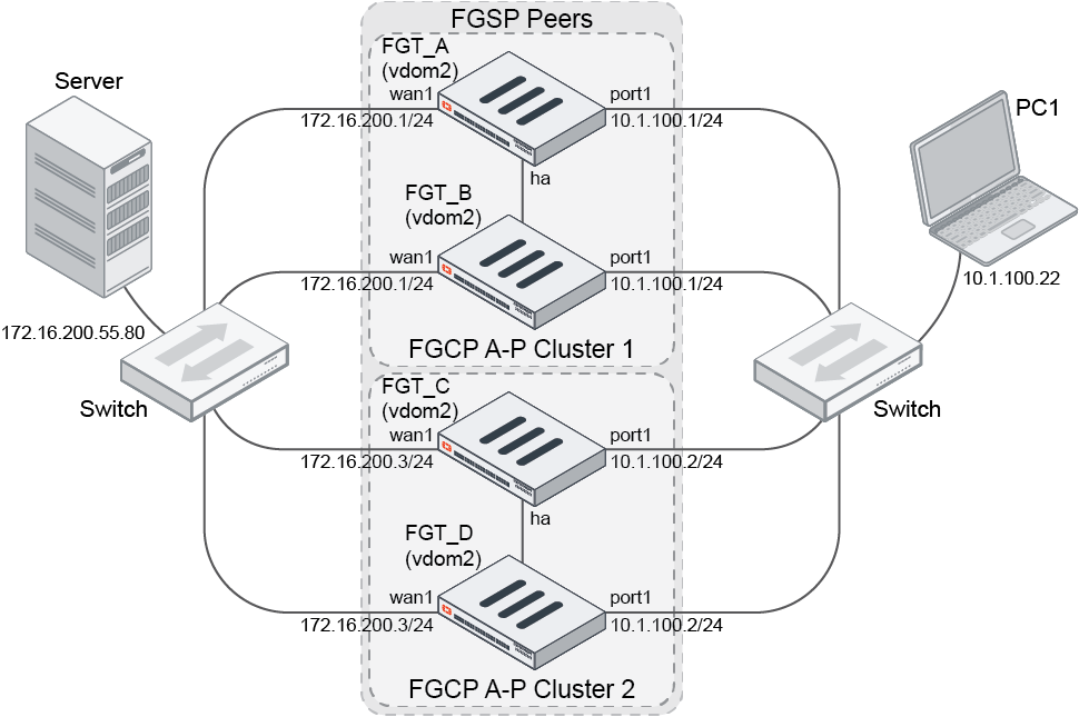

Example
In this example, there is a simplified configuration where there is no router or load balancer performing balancing between the FGSP peers, but it demonstrates the following:
  • When sessions pass through FGCP A-P Cluster 1, all sessions are synchronized between the FGT_A and FGT_B regardless of the session synchronization filter.
  • Session synchronization between the FGSP peers (FGCP A-P Cluster 1 and 2) only occurs for the service specified in the filter, which is HTTP/80.

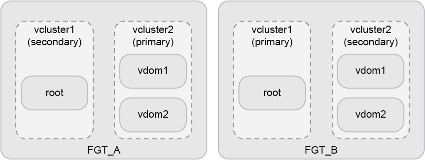

  • The preceding behavior is applicable when virtual clustering is configured. This example focuses on vdom2, which belongs to vcluster2. FGT_A is the primary for vcluster2.
Each FGSP A-P cluster is connected on ha as the FGCP cluster heartbeat device. The FGSP peers are connected on mgmt over 10.1.1.1-2/24.
Virtual clustering between FGT_A and FGT_B:

To configure the HA clusters:
  1. Configure FGCP A-P Cluster 1 (use the same configuration for FGT_A and FGT_B):
    config system ha
        set group-id 146
        set group-name "FGT_HA1"
        set mode a-p
        set hbdev "wan2" 100 "ha" 50
        set session-pickup enable
        set vcluster-status enable
        config vcluster
                set override enable
                set priority 25
                set monitor "wan1" "port1"
                set vdom "root"
                set override disable
                set priority 150
                set monitor "wan1"
                set vdom "vdom2" "vdom1"
  2. Configure FGCP A-P Cluster 2 (use the same configuration for FGT_C and FGT_D):
    config system ha
        set group-id 200
        set group-name "FGT_HA2"
        set mode a-p
        config vcluster
                set override enable
                set priority 120
                set vdom "root"
                set priority 150
                set monitor "wan1"
To configure the FGSP peers:
  1. Configure FGT_A:
    config system standalone-cluster
        set standalone-group-id 1
        set group-member-id 1
        config cluster-peer
                set peervd "vdom2"
                set peerip 10.1.1.2
                set syncvd "vdom2"
                config session-sync-filter
                    config custom-service
                            set dst-port-range 80-80
    The configuration is automatically synchronized to FGT_B.
  2. Configure FGT_C:
        set group-member-id 2
        config cluster-peer
                set peervd "vdom2"
                set peerip 10.1.1.1
                set syncvd "vdom2"
    The configuration is automatically synchronized to FGT_D.
To verify the configuration:
  1. Verify the FGSP peer information on Cluster 1:
    FGT_A (global) # diagnose sys ha fgsp-zone
    Local standalone-member-id: 1
    FGSP peer_num = 1
            peer[1]: standalone-member-id=2, IP=10.1.1.2, vd=vdom2, prio=1
  2. Verify the FGSP peer information on Cluster 2:
    FGT_C (global) # diagnose sys ha fgsp-zone
    FGSP peer_num = 1
            peer[1]: standalone-member-id=1, IP=10.1.1.1, vd=vdom2, prio=1
Interface
FGT_A
FGT_B
FGT_C
FGT_D
wan1
172.16.200.1/24
172.16.200.1/24
172.16.200.3/24
172.16.200.3/24
port1
10.1.100.1/24
10.1.100.1/24
10.1.100.2/24
10.1.100.2/24
mgmt
10.1.1.1/24
10.1.1.1/24
10.1.1.2/24
10.1.1.2/24
ha
    FGSP peer_num = 1
    FGSP peer_num = 1
  3. Initiate two sessions, HTTP and SSH.
  4. Verify that the HTTP session is synchronized from Cluster 1 to Cluster 2.
