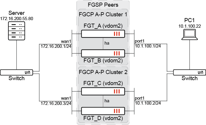

Applying the session synchronization filter only between FGSP peers in an FGCP over FGSP topology
When the session synchronization filter is applied on FGSP, the filter will only affect sessions synchronized between the FGSP peers. When virtual clustering is used, sessions synchronized between each virtual cluster can also be synchronized to FGSP peers. All peers' syncvd must be in the same HA virtual cluster.
Example
In this example, there is a simplified configuration where there is no router or load balancer performing balancing between the FGSP peers, but it demonstrates the following:
- When sessions pass through FGCP A-P Cluster 1, all sessions are synchronized between the FGT_A and FGT_B regardless of the session synchronization filter.
- Session synchronization between the FGSP peers (FGCP A-P Cluster 1 and 2) only occurs for the service specified in the filter, which is HTTP/80.
- The preceding behavior is applicable when virtual clustering is configured. This example focuses on vdom2, which belongs to vcluster2. FGT_A is the primary for vcluster2.
Each FGSP A-P cluster is connected on ha as the FGCP cluster heartbeat device. The FGSP peers are connected on mgmt over 10.1.1.1-2/24.
Virtual clustering between FGT_A and FGT_B:

To configure the HA clusters:
Configure FGCP A-P Cluster 1 (use the same configuration for FGT_A and FGT_B):
config system ha set group-id 146 set group-name "FGT_HA1" set mode a-p set hbdev "wan2" 100 "ha" 50 set session-pickup enable set session-pickup-nat enable set vcluster-status enable config vcluster edit 1 set override enable set priority 25 set monitor "wan1" "port1" set vdom "root" next edit 2 set override disable set priority 150 set monitor "wan1" set vdom "vdom2" "vdom1" next end end -

To configure the FGSP peers:
Configure FGT_A:
config system standalone-cluster set standalone-group-id 1 set group-member-id 1 config cluster-peer edit 1 set peervd "vdom2" set peerip 10.1.1.2 set syncvd "vdom2" config session-sync-filter config custom-service edit 1 set dst-port-range 80-80 next end end next end endThe configuration is automatically synchronized to FGT_B.

To verify the configuration:
Verify the FGSP peer information on Cluster 1:
FGT_A (global) # diagnose sys ha fgsp-zone Local standalone-member-id: 1 FGSP peer_num = 1 peer[1]: standalone-member-id=2, IP=10.1.1.2, vd=vdom2, prio=1 -
Verify the FGSP peer information on Cluster 2:
FGT_C (global) # diagnose sys ha fgsp-zone Local standalone-member-id: 1 FGSP peer_num = 1 peer[1]: standalone-member-id=1, IP=10.1.1.1, vd=vdom2, prio=1 -
Initiate two sessions, HTTP and SSH.
Verify that the HTTP session is synchronized from Cluster 1 to Cluster 2.
