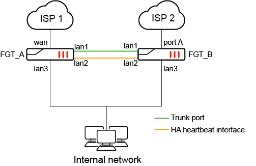

In this topology:
  • An HA cluster of two FortiGate 40Fs is used as an example
  • The lan interface is broken up into lan1, lan2 and lan3
  • lan1 is connected between FGT_A and FGT_B and designated as a virtual VLAN switch trunk port
  • lan2 is used for HA heartbeat, connecting the two FortiGates in HA
  • lan3 is connected to the internal network
  • wan is connected to ISP1 on FGT_A
  • port A is connected to ISP on FGT_B
Two VLANs are created (VLAN 10 and VLAN 20), and assigned to two VLAN switches. Each VLAN switch has the WAN interfaces (wan and port A) as its member.
When FGT_A is the primary device, it reaches ISP1 directly via the local wan interface and reaches ISP2 via the trunk port towards FGT_B. Packets are tagged/untagged as VLAN 10 as it passes through the trunk before egressing on port A on FGT_B.
When FGT_B is the primary device, it reaches ISP2 directly via the local port A interface and reaches ISP1 via the trunk port towards FGT_A. Packets are tagged/untagged as VLAN 20 as it passes through the trunk before egressing on the wan interface on FGT_A.
Using virtual VLAN switches for an SD-WAN HA configuration, as described in this example, requires fewer interfaces than the hardware switch configuration described in Configuring SD-WAN in an HA cluster using internal hardware switches
A virtual VLAN switch configuration with 2 WAN connections requires 5 interfaces. With 3 WAN connections, a total of 6 interfaces are required.
For the internal hardware switch solution, each WAN connection requires a corresponding hardware switch interface. With 2 WAN connections, a total of 6 interfaces are needed. With 3 WAN connections, a total of 8 interfaces are needed.
