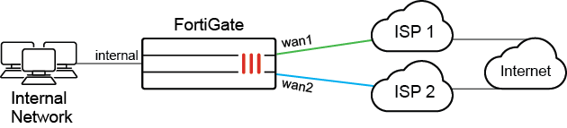

This example assumes that a standalone FortiGate has already been configured for SD-WAN by following the SD-WAN quick start.
Standalone FortiGate:

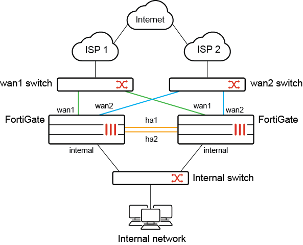

FGCP HA cluster:
The following devices are required to convert the topology to HA:
  • A second FortiGate that is the same model running the same firmware version.
  • Two switches for connecting each FortiGate's WAN interface to the corresponding ISP modem.

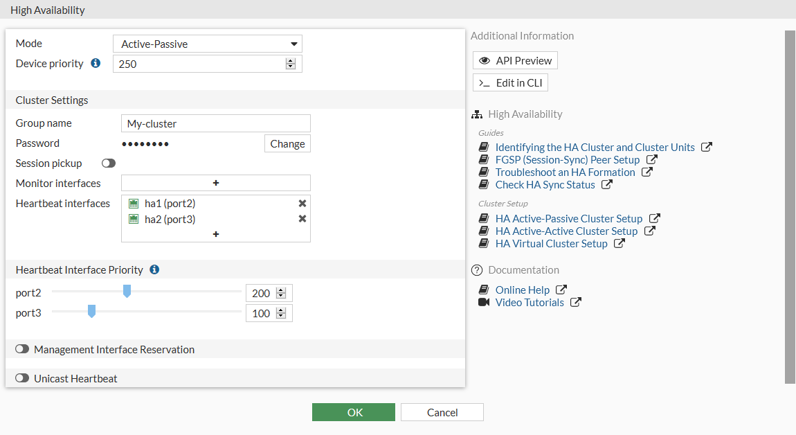

To configure the standalone FortiGate for HA in the GUI:
  1. Go to System > Settings and change the Host name so that the FortiGate can be easily identified as the primary unit.
  2. Go to System > HA and configure the following options:
    Mode
    Active-Passive
    Device priority
    250
    Group name
    My-cluster
    Password
    <password>
    Heartbeat interfaces
    ha1 and ha2
    Heartbeat Interface Priority
    port2 (ha1): 200
    port3 (ha2): 100
    Override and the group ID can only be configured from the CLI.
  3. Click OK.

Connecting other traffic interfaces
After the device configurations are synchronized, you can connect the rest of the traffic interfaces. Making these connections will disrupt traffic as cables are disconnected and reconnected.
Switches must be used between the cluster and the ISPs, and between the cluster and the internal network, as shown in the topology diagram.

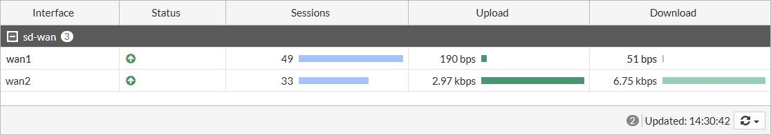

  1. Browse the internet on a computer in the internal network.

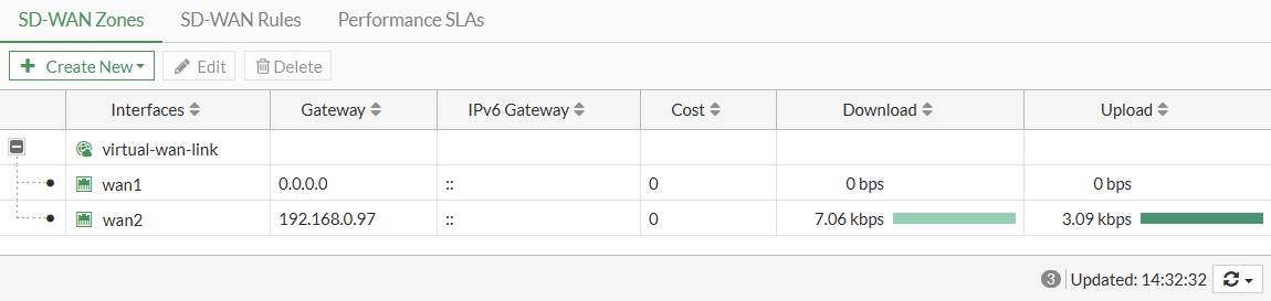

  2. Go to Network > SD-WAN > SD-WAN Zones to see the bandwidth, volume, and sessions for traffic on the SD-WAN interfaces. See Results for details.
  3. Go to Dashboard > Network Monitor > SD-WAN to see information about each interface, such as the number of sessions and the bit rate.

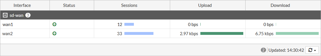

Testing ISP failover
To test a failover of the redundant internet configuration, you need to simulate a failed internet connection to one of the ports. You can do this by disconnecting power from the wan1 switch, or by disconnecting the wan1 interfaces of both FortiGates from ISP1.
After disconnecting, verify that users still have internet access
  • Go to Dashboard > Network Monitor > SD-WAN. The Upload and Download columns for wan1 show that traffic is not going through that interface.
  • Go to Network > SD-WAN > SD-WAN Zones. The Bandwidth, Volume, and Sessions tabs show that traffic is entirely diverted to wan2.
Users on the network should not notice the wan1 failure. If you are using the wan1 gateway IP address to connect to the administrator dashboard, it will appear as though you are still connecting through wan1.

To configure the secondary FortiGate for HA in the CLI:
  1. Change the host name so that the secondary FortiGate can be easily identified:
    config system global
        set hostname secondary_FG
  2. Configure HA:
    config system ha
        set mode a-p
        set group-id 100
        set group-name My-cluster
        set password <password>
        set priority 128
        set hbdev ha1 200 ha2 100
Connecting the heartbeat interfaces between the FortiGates
To connect and check the heartbeat interfaces:
  1. Connect the heartbeat interfaces ha1 and ha2 between the primary and secondary FortiGate.
