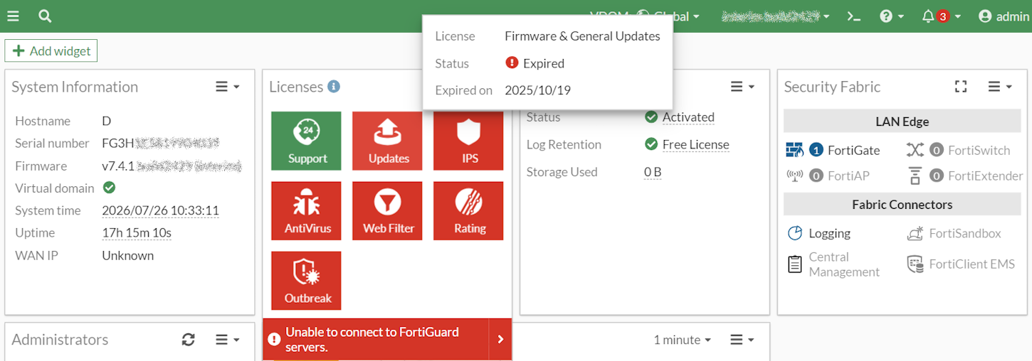

You can confirm the Firmware & General Updates (FMWR) contract expiry date in the System > FortiGuard page, by using the diagnose test update info contract | grep FMWR command, or by hovering your mouse over the Updates tile in the Licenses widget in Dashboard > Status.

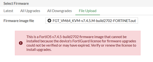

Upgrading firmware in the GUI through file upload
If the contract is expired relative to the major firmware GA .0 version release date, the following upgrade attempt will be blocked in the GUI System > Firmware & Registration page.
If the contract expiry date is earlier than the release date for the GA .0 version of a higher major, minor, or patch version of firmware that is being uploaded, then the upgrade is denied and an error is displayed.

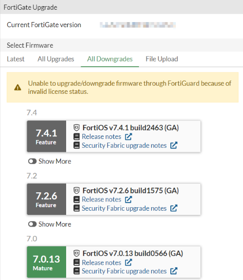

Upgrading firmware in the GUI through FortiGuard
Until the support contract is renewed, FortiGuard upgrades will be unavailable, namely, the Confirm and Backup Config button will be grayed out. However, you will be able to view the FortiGate firmware images available on FortiGuard using Latest, All Upgrades, and All Downgrades tabs and this functionality will be restored upon support contract renewal.

To verify the presence of the FMWR license:
# diagnose test update info contract
System contracts:
    ENHN,Thu May  1 2025
    COMP,Thu May  1 2025
    FMWR,Thu May  1 2025
