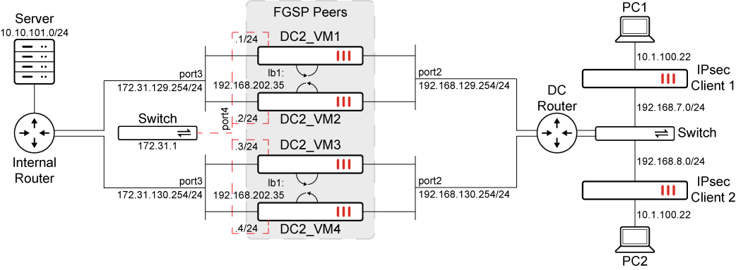

In this example, the FGSP peers are connected on port4 over 172.31.1.1-4/24. Each peer has a loopback interface, lb1, with the same IP address. This loopback interface is used as the local gateway on each of the phase 1 connections to avoid each FGSP member having different IPs on port2. The DC Router uses ECMP to distribute traffic to each FGSP peer. It is assumed that the networking addresses are already configured properly.

Out of the four FGSP peers, DC1_VM1, DC1_VM2, and DC1_VM3 have fgsp-sync enabled in their IPsec phase 1 configurations. This allows the three FGSP members to synchronize IPsec SAs as clients establish dialup tunnels to them individually. DC1_VM4, which does not have fgsp-sync configured, will not participate in synchronizing IPsec SAs or establishing tunnels. The DC Router uses ECMP to route traffic to the destination 192.168.202.31 through each of the participating FGSP peers.
In a larger scale there may be many more IPsec dialup clients connecting, with each eligible FGSP peer being the primary gateway for a set of dialup tunnels, and is in standby for the rest of the tunnels. If an FGSP peer fails, traffic will fail over to other peers, and these peers will become primary gateways for the respective dialup tunnels.
