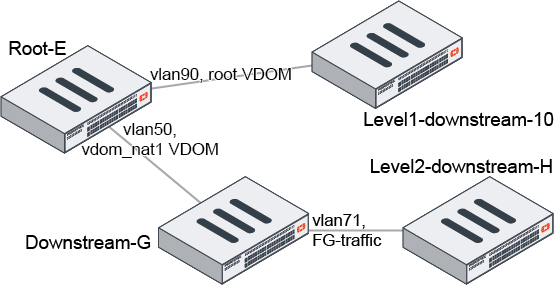

Topology
In this topology, there is a root FortiGate with three FortiGates connected through two different VDOMs. The root FortiGate is able to manage all devices running in multi-VDOM mode.

Root FortiGate (Root-E)
The Security Fabric is enabled, and configured so that downstream interfaces from all VDOMs can allow other Security Fabric devices to join.

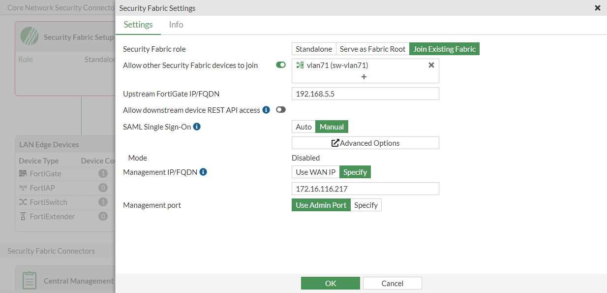

Downstream FortiGate 1 (Downstream-G)
To configure Downstream-G in the GUI:
- Go to Security Fabric > Fabric Connectors and double-click the Security Fabric Setup card.
- In the Settings tab, set the Security Fabric role to Join Existing Fabric.
- Enter the Upstream FortiGate IP, which is the IP of the root FortiGate vdom_nat1 interface (192.168.5.5). Downstream-G must use the interface from the management VDOM to connect to the upstream FortiGate IP.
- Enable Allow other Security Fabric devices to join and click the + to add the downstream interface (sw-vlan71) from the FG-traffic VDOM.
- Configure the other settings as needed.
- Click OK.

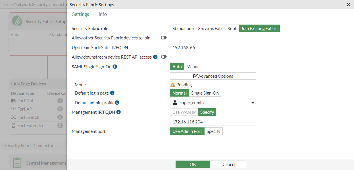

Downstream FortiGate 3 (Level1-downstream-10)
To configure Level1-downstream-10 in the GUI:
- Enter the Upstream FortiGate IP, which is the IP of the root VDOM on Root-E (192.168.9.5).
- Click OK.
