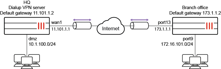

FortiGate as dialup client
This is a sample configuration of dialup IPsec VPN and the dialup client. In this example, a branch office FortiGate connects via dialup IPsec VPN to the HQ FortiGate.
You can configure dialup IPsec VPN with FortiGate as the dialup client using the GUI or CLI.

To configure IPsec VPN with FortiGate as the dialup client in the CLI:
- In the CLI, configure the user, user group, and firewall address. Only the HQ dialup server FortiGate needs this configuration. The address is an IP pool to assign an IP address for the dialup client FortiGate.
config user local edit "vpnuser1" set type password set passwd your-password next end config user group edit "vpngroup" set member "vpnuser1" next end config firewall address edit "client_range" set type iprange set start-ip 10.10.10.1 set end-ip 10.10.10.200 next end - Configure the WAN interface and default route. The WAN interface is the interface connected to the ISP. It can work in static mode (as shown in this example), DHCP, or PPPoE mode. The IPsec tunnel is established over the WAN interface.
- Configure the HQ FortiGate.
config system interface edit "wan1" set vdom "root" set ip 11.101.1.1 255.255.255.0 next end config router static edit 1 set gateway 11.101.1.2 set device "wan1" next end - Configure the branch office FortiGate.
config system interface edit "port13" set vdom "root" set ip 173.1.1.1 255.255.255.0 next end config router static edit 1 set gateway 173.1.1.2 set device "port13" next end

- Configure the internal interface and protected subnet. The internal interface connects to the internal network. Traffic from this interface will route out the IPsec VPN tunnel.
config system interface edit "dmz" set vdom "root" set ip 10.1.100.1 255.255.255.0 next end config firewall address edit "10.1.100.0" set subnet 10.1.100.0 255.255.255.0 next end - Configure the branch office FortiGate.
config system interface edit "port9" set vdom "root" set ip 172.16.101.1 255.255.255.0 next end config firewall address edit "172.16.101.0" set subnet 172.16.101.0 255.255.255.0 next end
