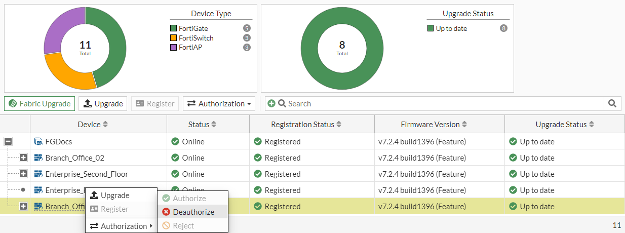

- Go to System > Firmware & Registration and select a downstream FortiGate in the table.
- Right-click on the device and select Authorization > Deauthorize.

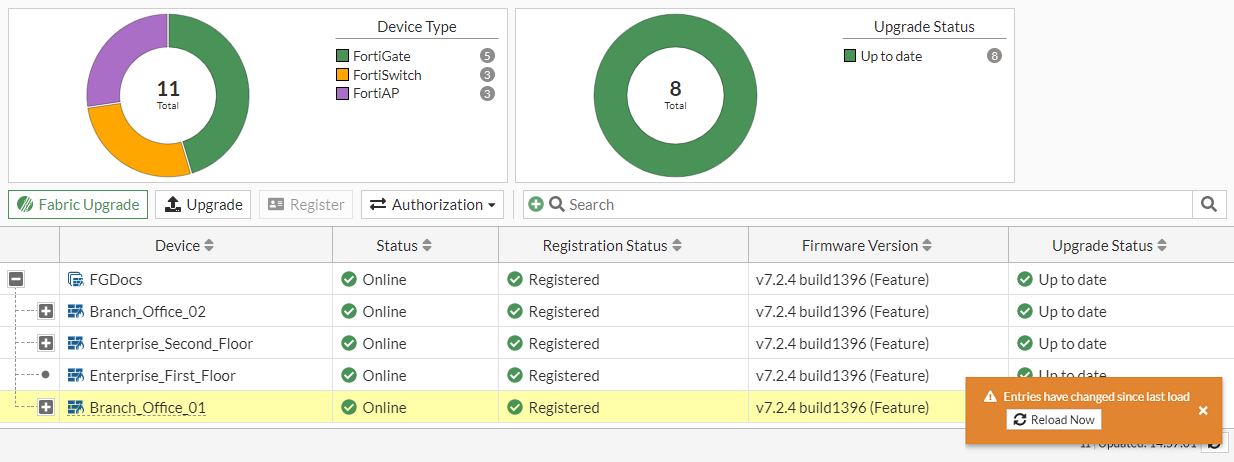

- An alert appears in the bottom-right corner of the page. Click Reload Now to refresh the page.

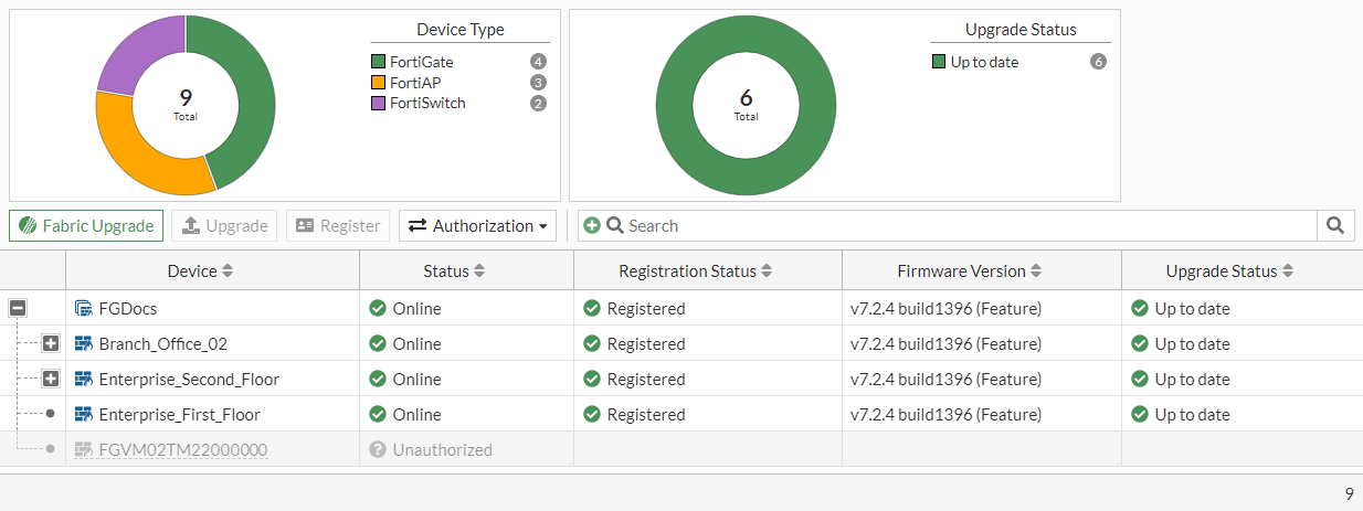

The deauthorized FortiGate's status is now listed as Unauthorized.
