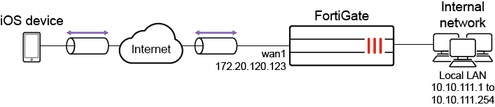

This is a sample configuration of dialup IPsec VPN with an iPhone or iPad as the dialup client.
You can configure dialup IPsec VPN with an iOS device as the dialup client using the GUI or CLI.
This example shows VPN configurations in IKEv1. Starting with FortiClient 7.4.4, IKEv1 is no longer supported on the client. Therefore, plan accordingly when choosing your IKE version. Use IKEv2 if you plan on deploying FortiClient 7.4.4 and later.

To configure IPsec VPN with an iOS device as the dialup client using the CLI:
  1. In the CLI, configure the user and group.

  2. Configure the internal interface. The LAN interface connects to the corporate internal network. Traffic from this interface routes out the IPsec VPN tunnel. Creating an address group for the protected network behind this FortiGate causes traffic to this network group to go through the IPsec tunnel.
    config system interface
        edit "lan"
            set vdom "root"
            set ip 10.10.111.1 255.255.255.0

  3. Configure the WAN interface. The WAN interface is the interface connected to the ISP. It can work in static mode (as shown in this example), DHCP, or PPPoE mode. The IPsec tunnel is established over the WAN interface.
        edit "wan1"
            set vdom "root"
            set ip 172.20.120.123 255.255.255.0

  9. Run diagnose commands to check the IPsec phase1/phase2 interface status. The diagnose debug application ike -1 command is the key to troubleshoot why the IPsec tunnel failed to establish.
    1. Run the diagnose vpn ike gateway list command. The system should return the following:
