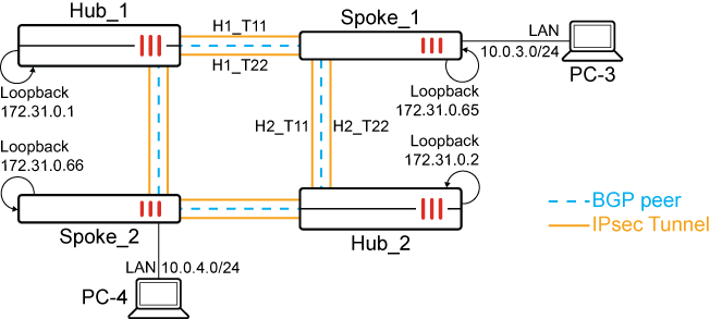

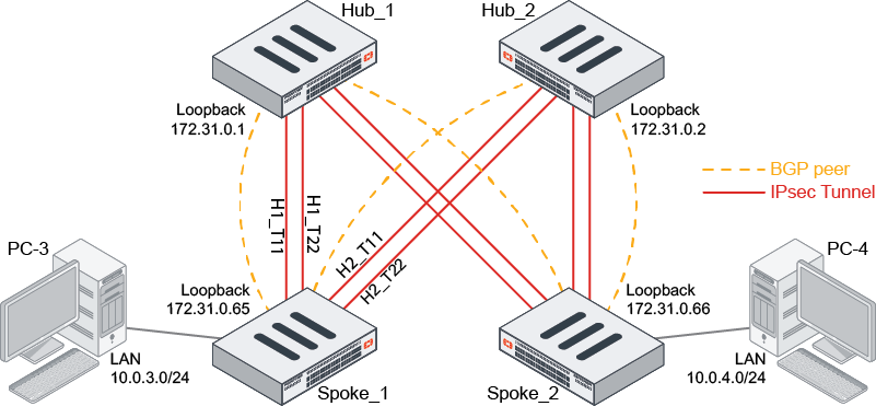

Each spoke has two IPsec tunnels to each hub, and one BGP peer on loopback interface to each hub (route-reflector).
The loopbacks are exchanged with IKE between the spokes and hubs. They are installed as static routes that are used to provide reachability for establishing BGP neighbors.
The summary BGP routes from the loopback IP address ranges that originated on the hubs are advertised to the spokes for resolving the BGP next hop s on the spokes.
The spokes' PC LAN subnets are reflected by the hubs.
Spoke_1 receives BGP routes (the LAN subnet and loopback IP summary) from Hub_1 with tag 1 and from Hub_2 with tag 2.
SD-WAN is enabled on Spoke_1, and all of the tunnels are SD-WAN members.

If the connections between Hub_1 and Spoke_2 are down, traffic from PC_3 to PC_4 can still go through Hub_1 because of the best-match resolving on Spoke_1, but packets will be dropped on Hub_1. When tag-match is enabled on Spoke_1, the spoke will resolve the PC_4 LAN route to Hub2, and traffic will be forwarded to Hub_2 and reach its destination.

When connections between Spoke_2 and Hub_1 fails due to the BGP neighbor, tunnels, or physical ports going down, the PC_4 LAN route can be still resolved to Hub_1 and Hub_2 because the loopback IP summary can still be received from both Hub_1 and Hub_2:
