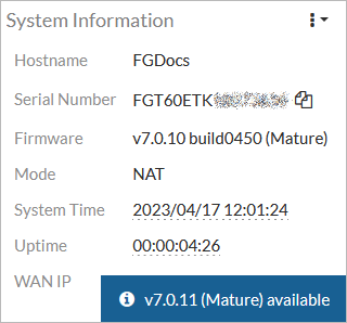

To view maturity levels for firmware in the GUI:
Go to Dashboard > Status. The Firmware field in the System Information widget displays the version with build number and either (Mature) or (Feature).
The following is an example of firmware with the (Mature) tag:

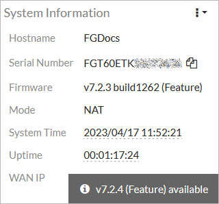

The following is an example of firmware with the (Feature) tag:

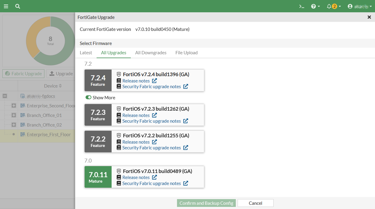

Go to System > Firmware & Registration. The Firmware Version column displays the version with build number and either (Mature) or (Feature).
Select a device and click Upgrade. The FortiGate Upgrade pane is displayed.
Click the Latest tab to view the latest available firmware version with its maturity level.
Click the All Upgrades tab to view all available firmware versions and their maturity levels.
A gray box around the version number and the label Feature identifies feature firmware version. A green box around the version with the label Mature identifies a mature firmware version.

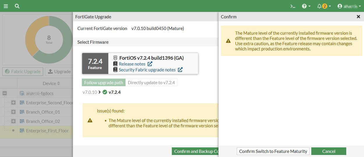

Select a version and click Confirm and Backup Config.
When the firmware version is a feature release, a warning is displayed; click Confirm Switch to Feature Maturity.
