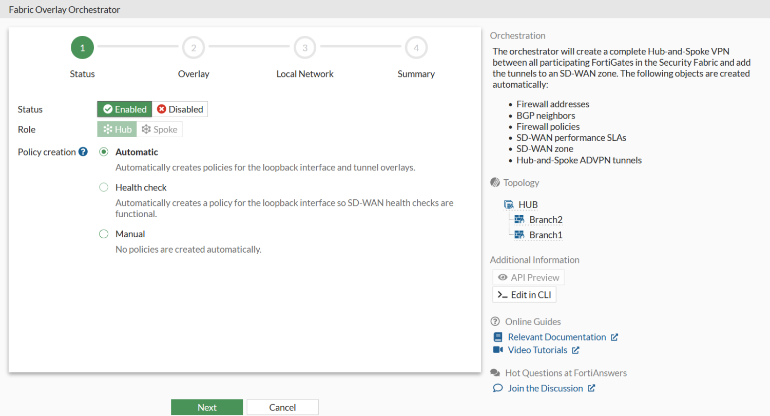

To configure the root FortiGate using the Fabric Overlay Orchestrator:
Go to VPN > Fabric Overlay Orchestrator.
Set the Status to Enabled. The Role is automatically selected based on the FortiGate's role in the Security Fabric. Ensure that Hub is selected. The Fabric root must always be the hub.
Set Policy creation to Automatic.

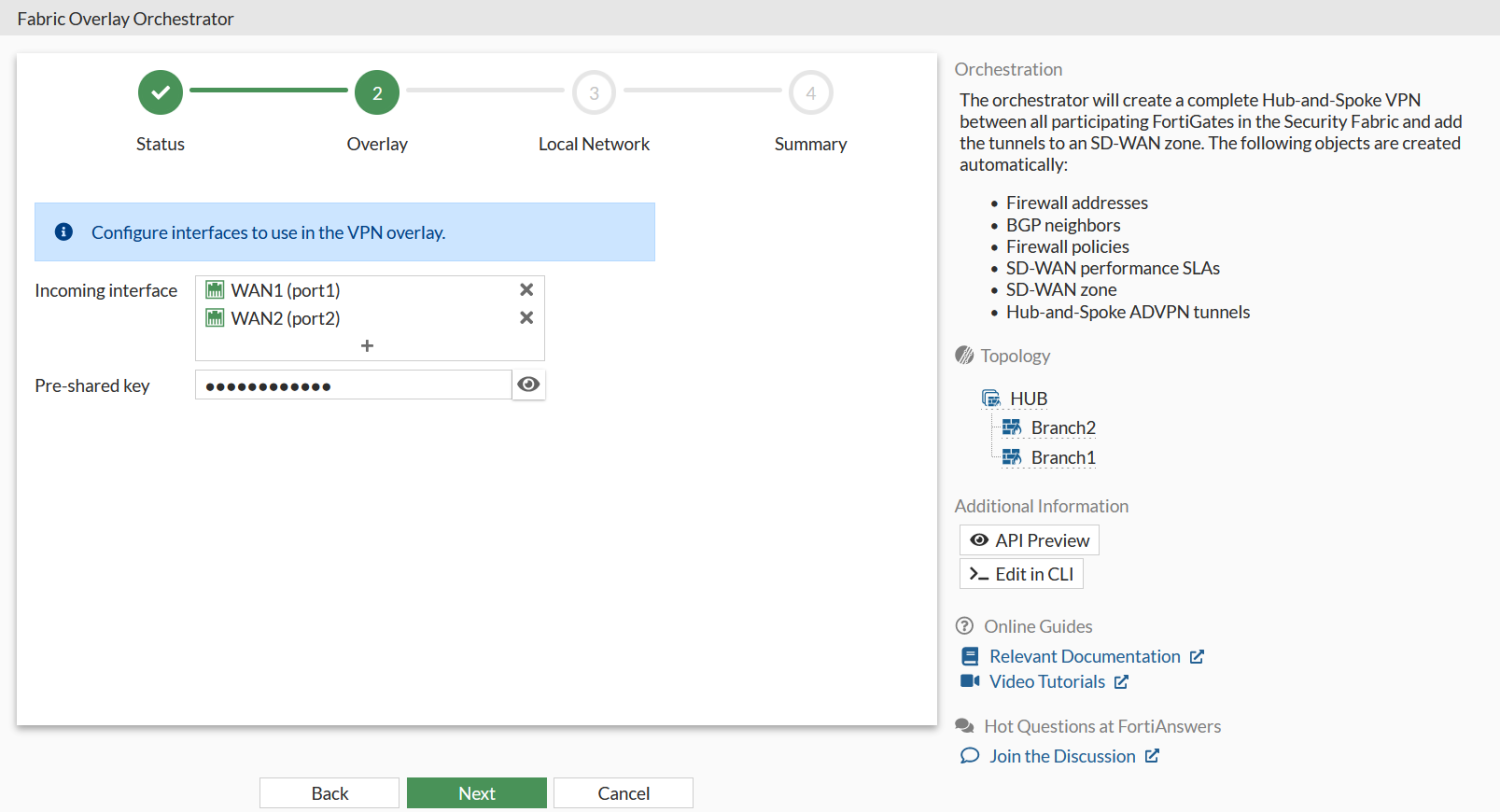

Click Next. The Overlay settings appear.
Select one or more interfaces as the Incoming interface or the underlay link over which the VPN overlay will be built (two incoming interfaces are selected in this example).
Enter the Pre-shared key.

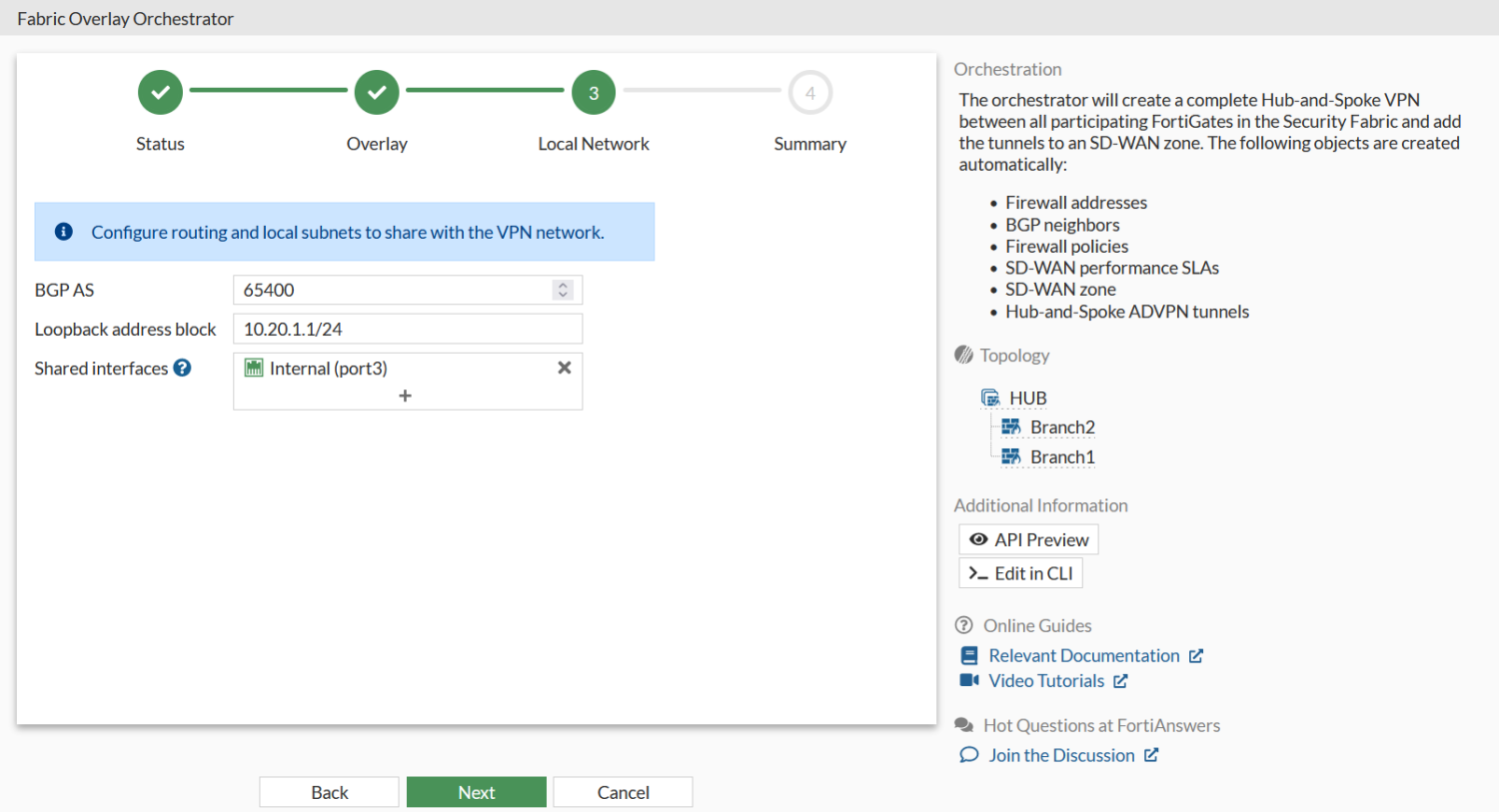

Click Next. The Local Network settings appear.
Configure routing and local subnets to share the following with the VPN network:
BGP AS
Optional setting to configure the BGP AS number. By default, this is set to 65400.
Loopback address block
Optional setting to configure the loopback IP address. By default, this is set to 10.20.1.1/255.255.255.0.
Shared interfaces
Select the interface of the local network to share with the VPN network.

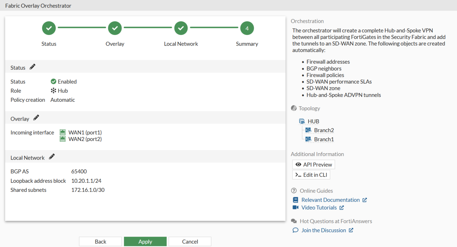

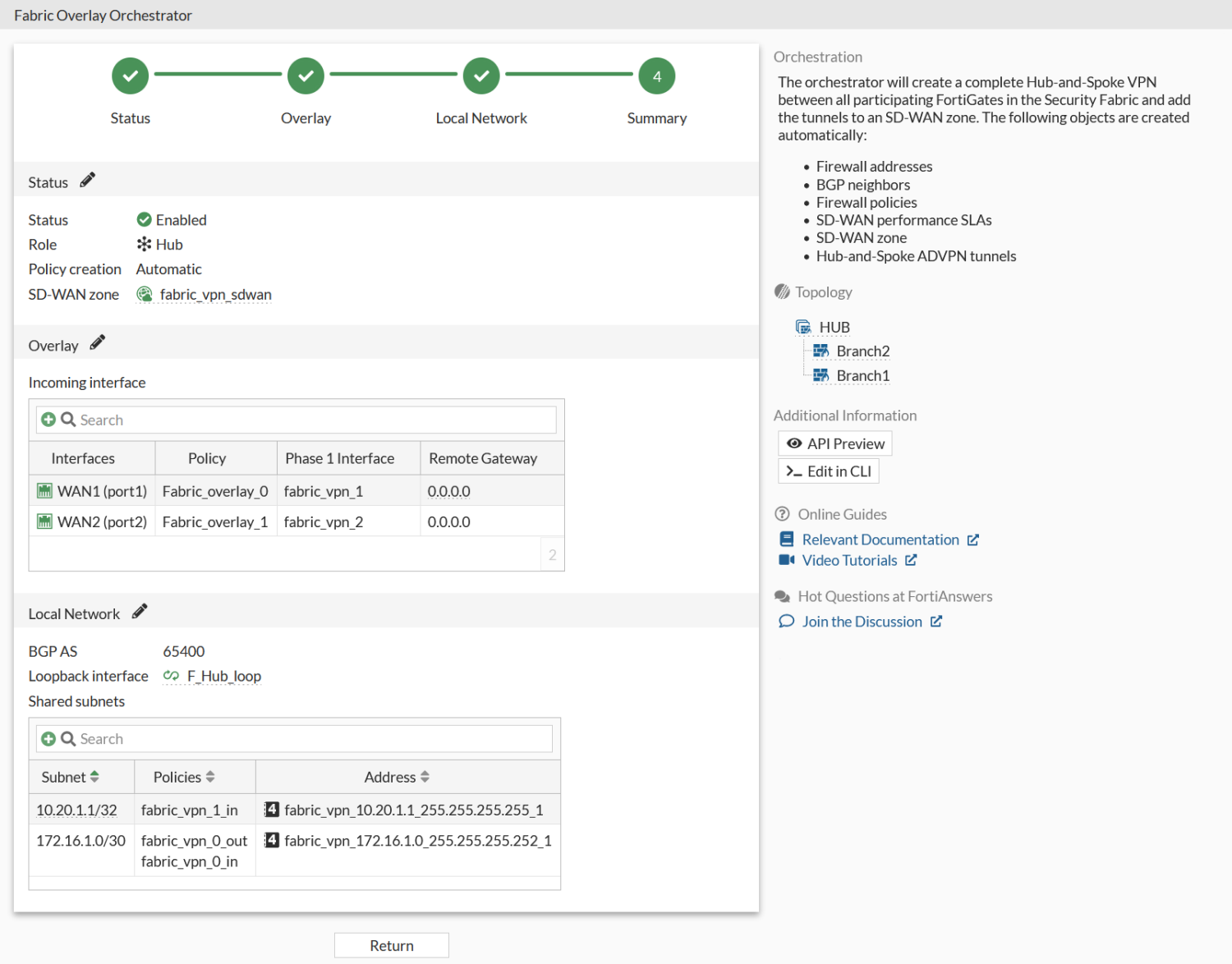

Click Next. The Summary page appears.
Review the settings, then click Apply.
An updated Summary page appears with all the settings.
Note the following settings in this example:
SD-WAN zone
Located in the Status section: fabric_vpn_sdwan.
VPN tunnels
Located in the Overlay section in the Incoming interface table under the Phase 1 Interface column: fabric_vpn1 and fabric_vpn2.
BGP
Located in the Local Network section. The BGP AS is 65400. The Shared subnets are 10.20.1.1/32 and 172.16.1.0/30.
Loopback interface
Located in the Local Network section: F_Hub_loop.
Firewall policies
Located in two sections:
- Overlay section in the Incoming interface table under the Policy column: Fabric_overlay_0 and Fabric_overlay_1
- Local Network section in the Shared subnets table under the Policies column: fabric_vpn_1_in, fabric_vpn_0_out, and fabric_vpn_0_in

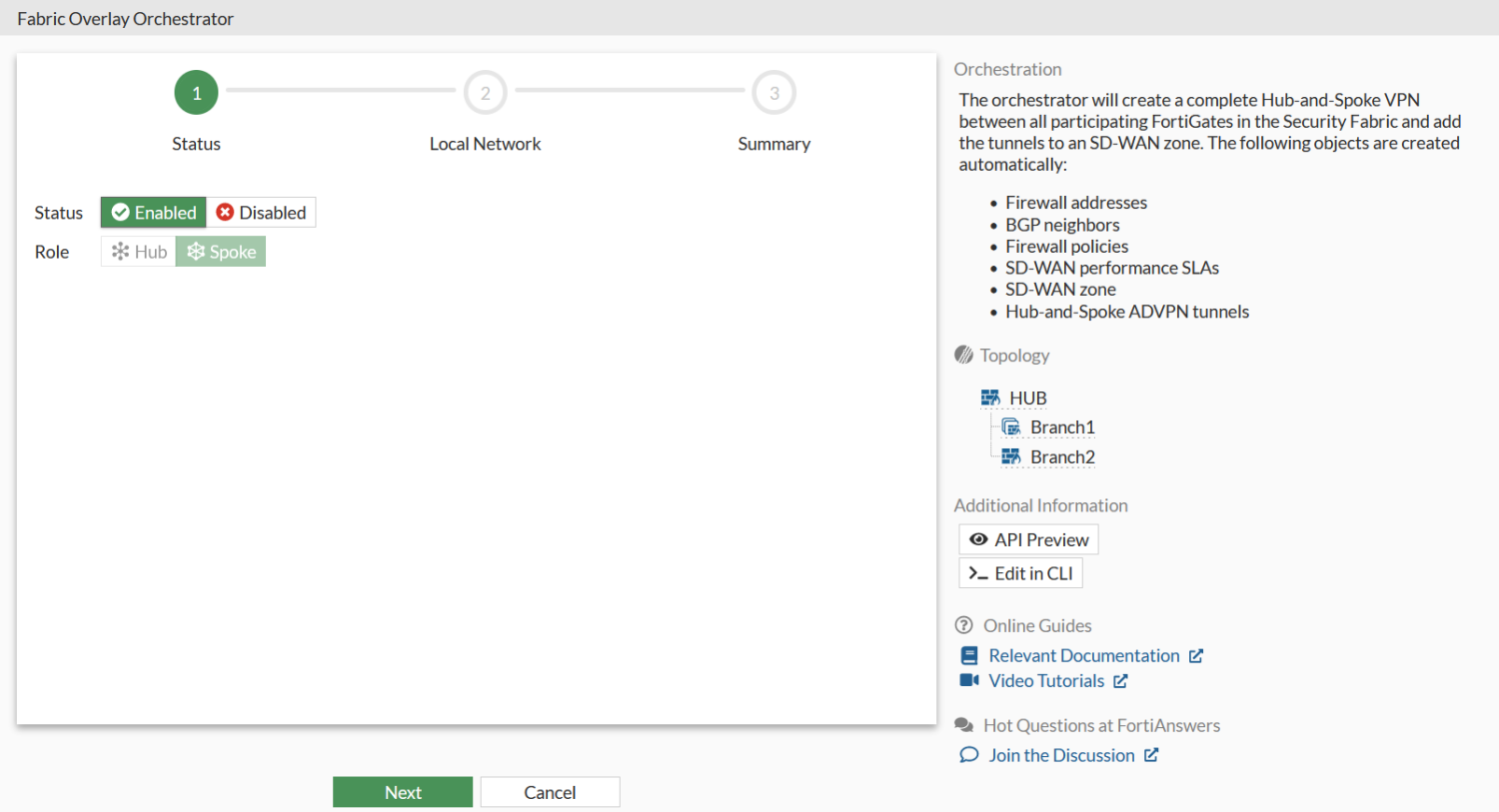

To configure a downstream FortiGate using the Fabric Overlay Orchestrator:

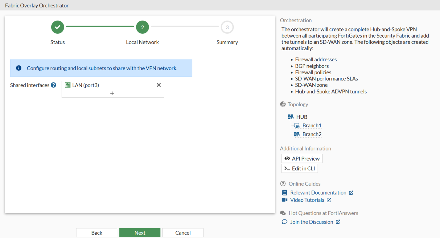

Set the Status to Enabled. The Role is automatically selected based on the FortiGate's role in the Security Fabric. Ensure that Spoke is selected. Only downstream first-level FortiGates can be spokes.

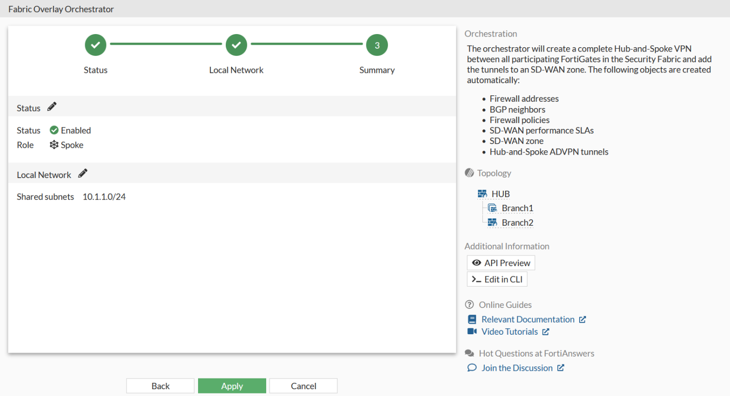

Configure the routing and local subnets to share with the VPN network in the following fields:
Shared interfaces

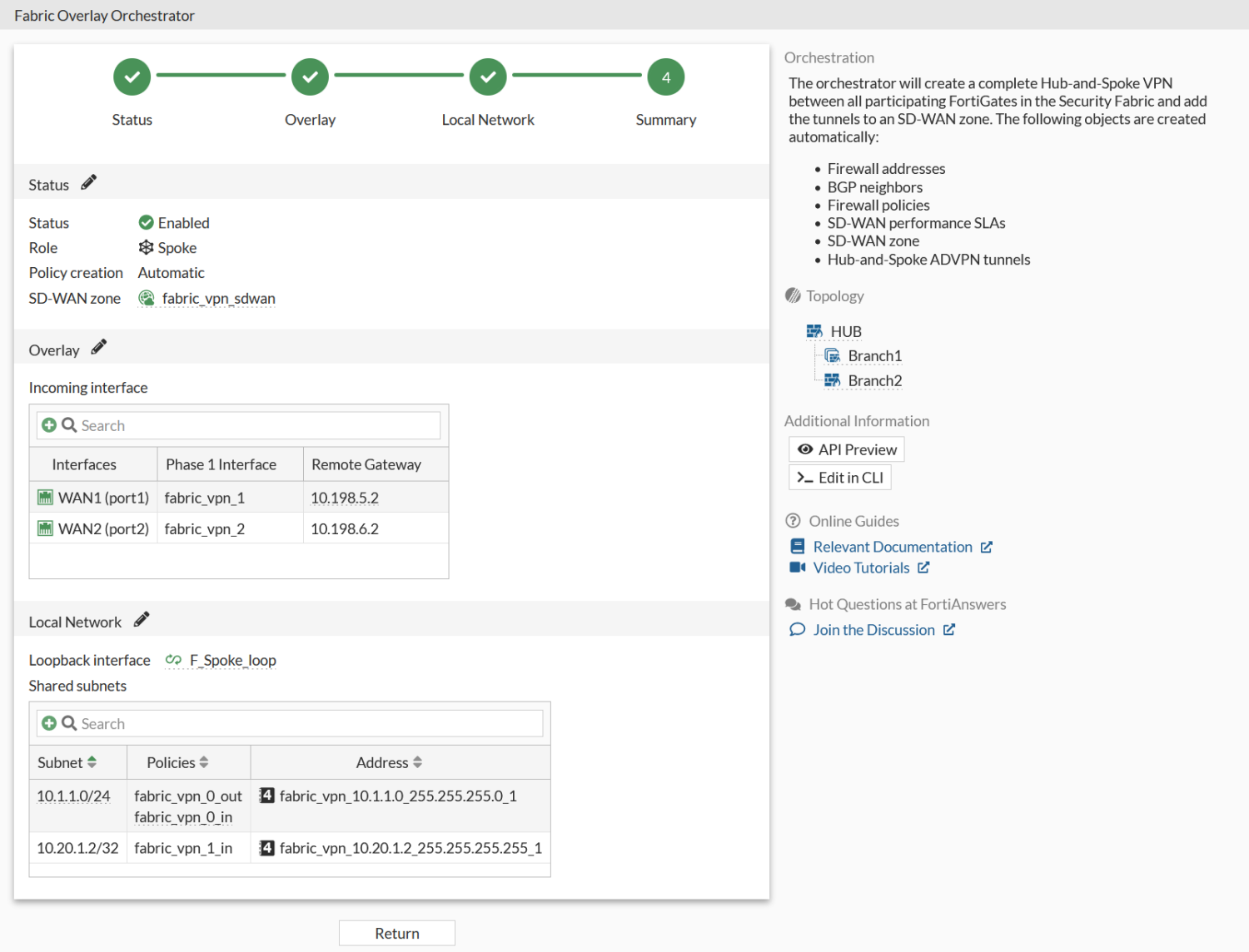

Click Next. As the downstream FortiGate updates, a Configuring spoke Fabric VPN from root FortiGate message appears The Summary page appears once the update is complete.
SD-WAN zone
VPN tunnels
Located in the Overlay section in the Incoming interface table under the Phase 1 Interface column: fabric_vpn1.
BGP
Located in the Local Network section. The BGP AS is 65400. The Shared subnets are 10.1.1.0/24 and 10.20.1.2/32.
Loopback interface

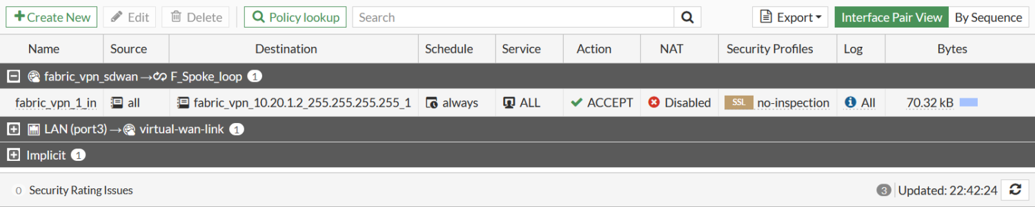

Firewall policies
Located in the Local Network section in the Shared subnets table under the Policies column: fabric_vpn_0_out, fabric_vpn_0_in, and fabric_vpn_1_in.

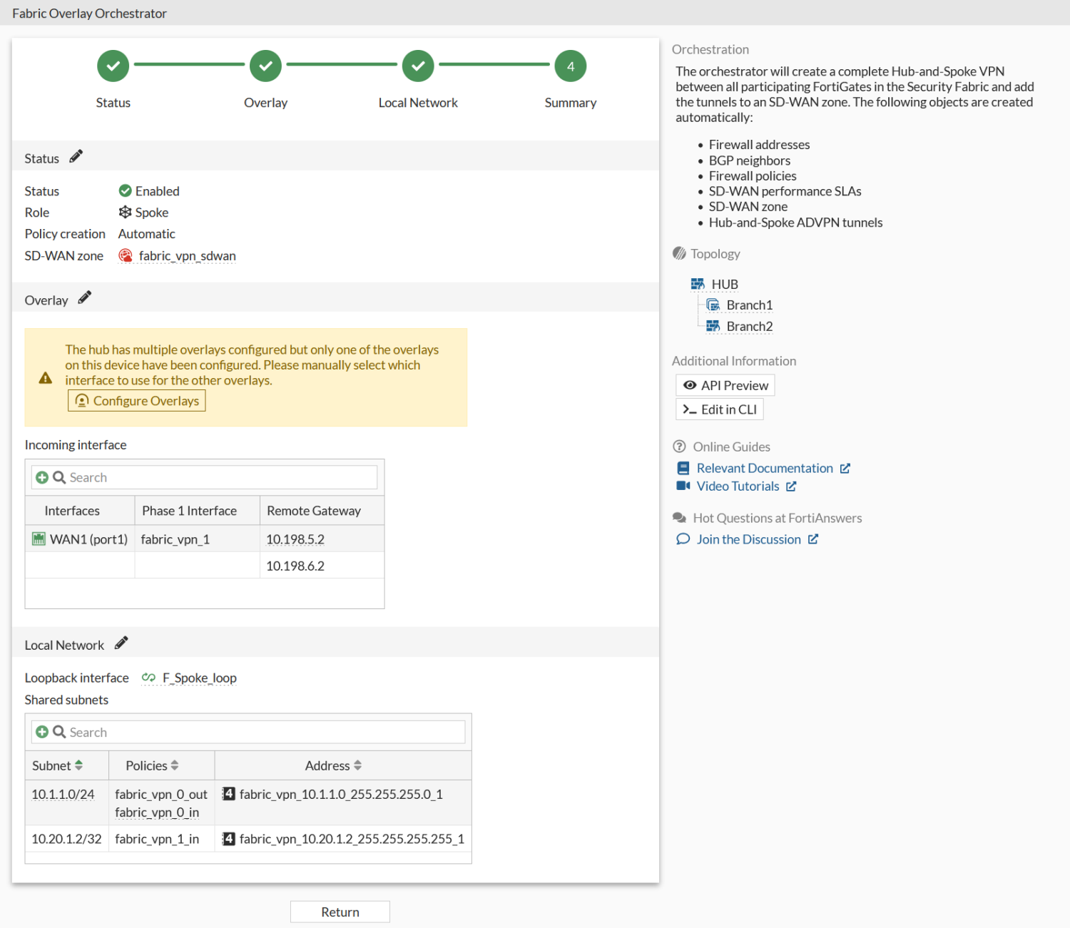

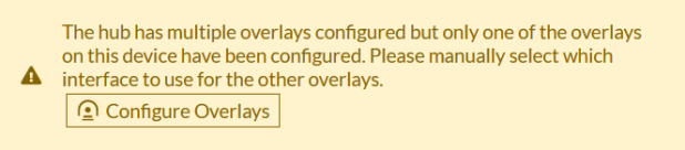

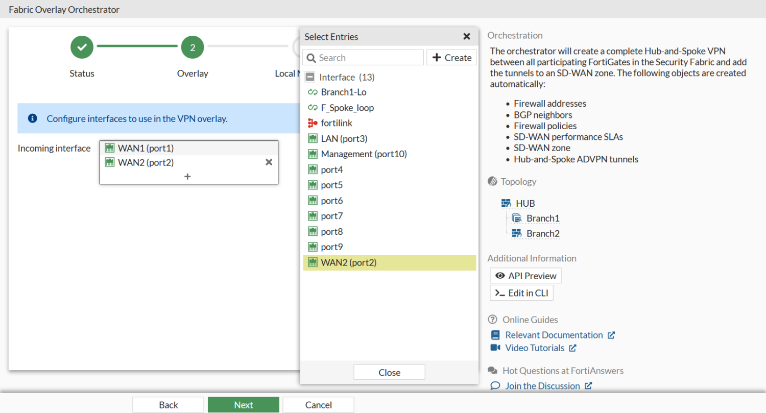

Configuring an overlay on the spoke for an additional incoming interface on the hub
A hub typically includes two incoming interfaces, but additional interfaces can be configured if needed. On downstream devices, the following warning is displayed on the Fabric Overlay Orchestrator page that The hub has multiple overlays configured but only one of the overlays on this device have been configured. Please manually select which interface to use for the other overlays.
To configure an additional incoming interface on a spoke:
Click Configure Overlays in the warning box.
Navigate to the Overlay section, click the + in the Incoming interface field, and select WAN2 (port2) to add it to the overlay.
Click Next, then complete the remaining steps in the GUI wizard. On the Summary page, the additional interface WAN2 (port2) appears in the Incoming interfaces table.

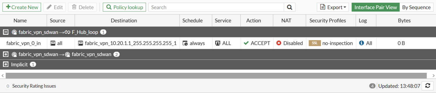

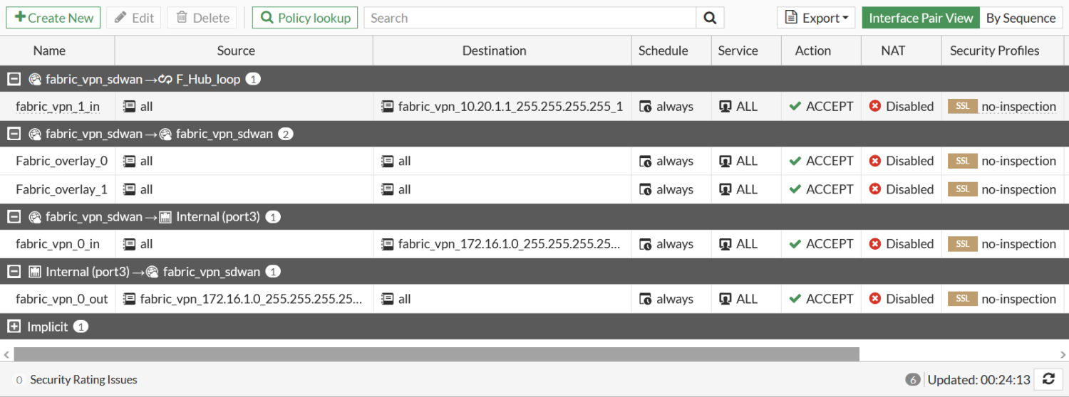

Verifying the firewall policies on the hub FortiGate
Different policies are created on the hub FortiGate based on the Policy creation setting in the Fabric Overlay Orchestrator configuration (Automatic, Health check, or Manual).
Automatic
Go to Policy & Objects > Firewall Policy to verify that wildcard firewall policies have been configured on the hub FortiGate. This Fabric Overlay Orchestrator configuration example uses automatic policy creation, and the following firewall policies are configured:
The Automatic policy creation option creates wildcard allow policies for the tunnel overlays. For some cases, these policies do not provide the necessary granularity to restrict overlay traffic to specific subnets or hosts. |
Health check
Go to Policy & Objects > Firewall Policy to verify that a single firewall policy allowing health check traffic to the hub’s loopback has been configured on the hub FortiGate. For example:
Manual
Go to Policy & Objects > Firewall Policy to verify that no firewall policies have been created by the Fabric Overlay Orchestrator. If desired, firewall policies must be manually configured on the hub FortiGate to allow traffic to the loopback interface for health checks and the overlays.

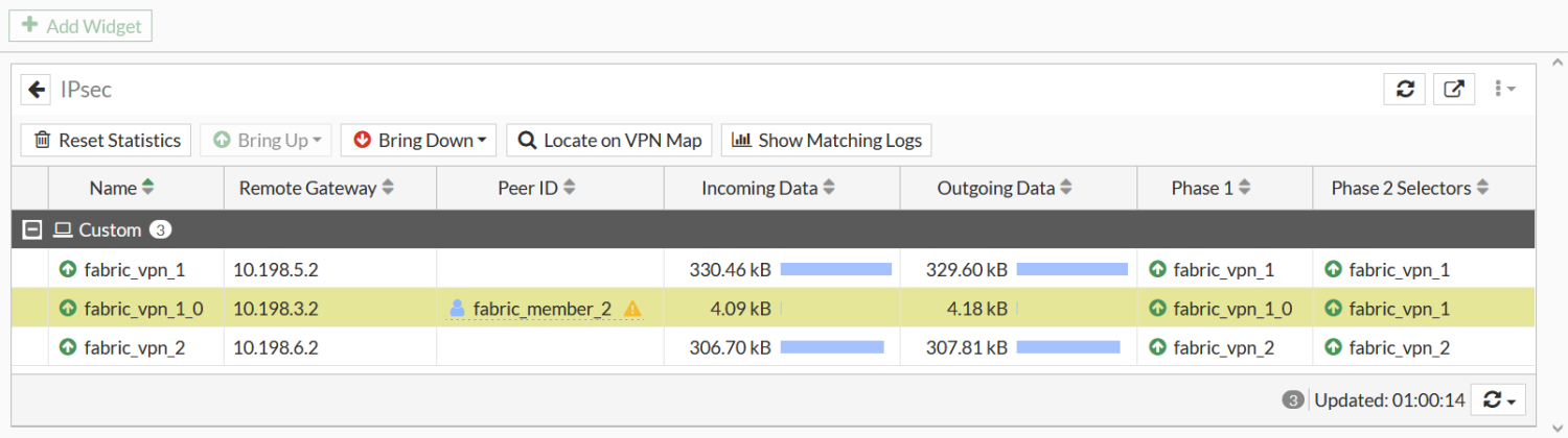

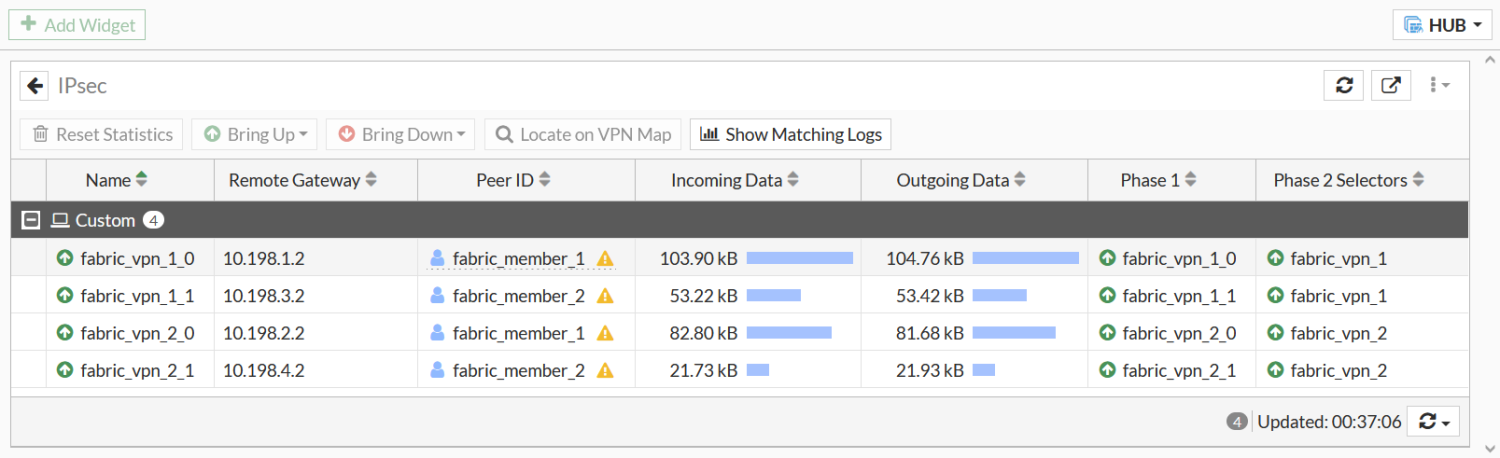

To verify the IPsec VPN tunnels on the hub:
Go to Dashboard > Network and click the IPsec widget to expand it.
Verify that there are two tunnels established for each phase 1 interface.
The naming convention <tunnel_name>_<number> indicates the relative order in which the tunnels were established:
fabric_vpn_1_0
VPN tunnel listening on the hub’s WAN1 incoming interface; established with spoke 1 using its WAN1 interface
fabric_vpn_1_1
VPN tunnel listening on the hub’s WAN1 incoming interface; established with spoke 2 using its WAN1 interface
fabric_vpn_2_0
VPN tunnel listening on the hub’s WAN2 incoming interface; established with spoke 1 using its WAN2 interface
fabric_vpn_2_1
VPN tunnel listening on the hub’s WAN2 incoming interface; established with spoke 2 using its WAN2 interface

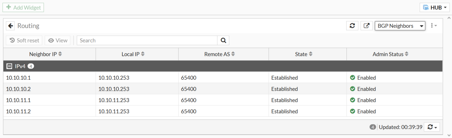

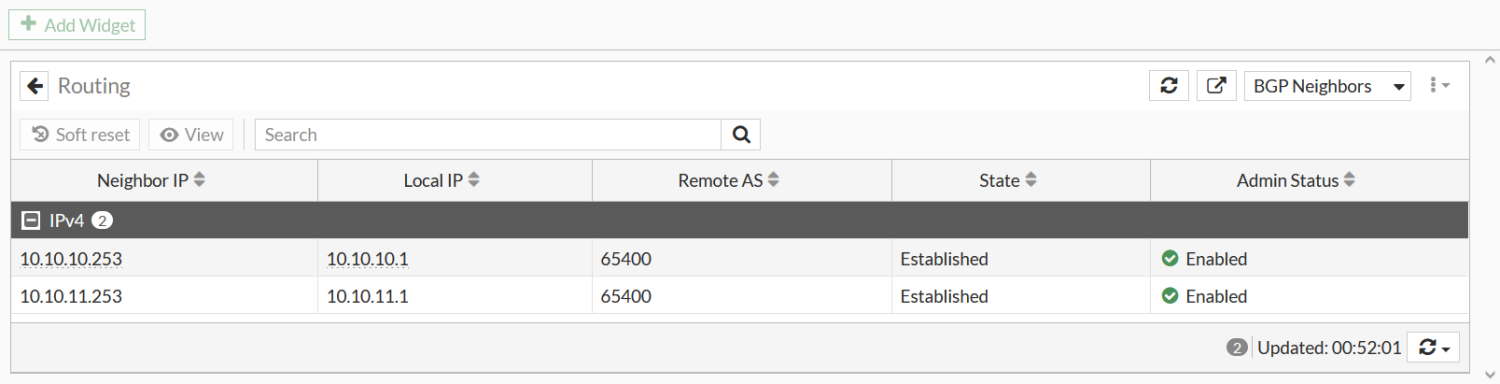

Verify the BGP routing on the hub:
In the CLI, check the BGP peering status:
HUB # get router info bgp summary VRF 0 BGP router identifier 10.20.1.1, local AS number 65400 BGP table version is 11 1 BGP AS-PATH entries 0 BGP community entries Next peer check timer due in 43 seconds Neighbor V AS MsgRcvd MsgSent TblVer InQ OutQ Up/Down State/PfxRcd 10.10.10.1 4 65400 23 27 11 0 0 00:09:28 2 10.10.10.2 4 65400 16 16 11 0 0 00:06:36 2 10.10.11.1 4 65400 14 20 11 0 0 00:09:22 2 10.10.11.2 4 65400 7 11 11 0 0 00:03:22 2 Total number of neighbors 4
Check the BGP advertised routes:
HUB # get router info bgp neighbors 10.10.10.1 advertised-routes VRF 0 BGP table version is 11, local router ID is 10.20.1.1 Status codes: s suppressed, d damped, h history, * valid, > best, i - internal Origin codes: i - IGP, e - EGP, ? - incomplete Network Next Hop Metric LocPrf Weight RouteTag Path *>i10.1.1.0/24 10.10.11.1 100 0 0 i <-/2> *>i10.1.2.0/24 10.10.11.2 100 0 0 i <-/2> *>i10.1.2.0/24 10.10.10.2 100 0 0 i <-/1> *>i10.10.10.0/24 10.10.10.253 100 32768 0 i <-/1> *>i10.10.11.0/24 10.10.10.253 100 32768 0 i <-/1> *>i10.20.1.1/32 10.10.10.253 100 32768 0 i <-/1> *>i10.20.1.2/32 10.10.11.1 100 0 0 i <-/2> *>i10.20.1.3/32 10.10.11.2 100 0 0 i <-/2> *>i10.20.1.3/32 10.10.10.2 100 0 0 i <-/1> *>i172.16.1.0/30 10.10.10.253 100 32768 0 i <-/1> Total number of prefixes 10
In the GUI, go to Dashboard > Network and click the Routing widget to expand it.
In the dropdown, select BGP Neighbors.

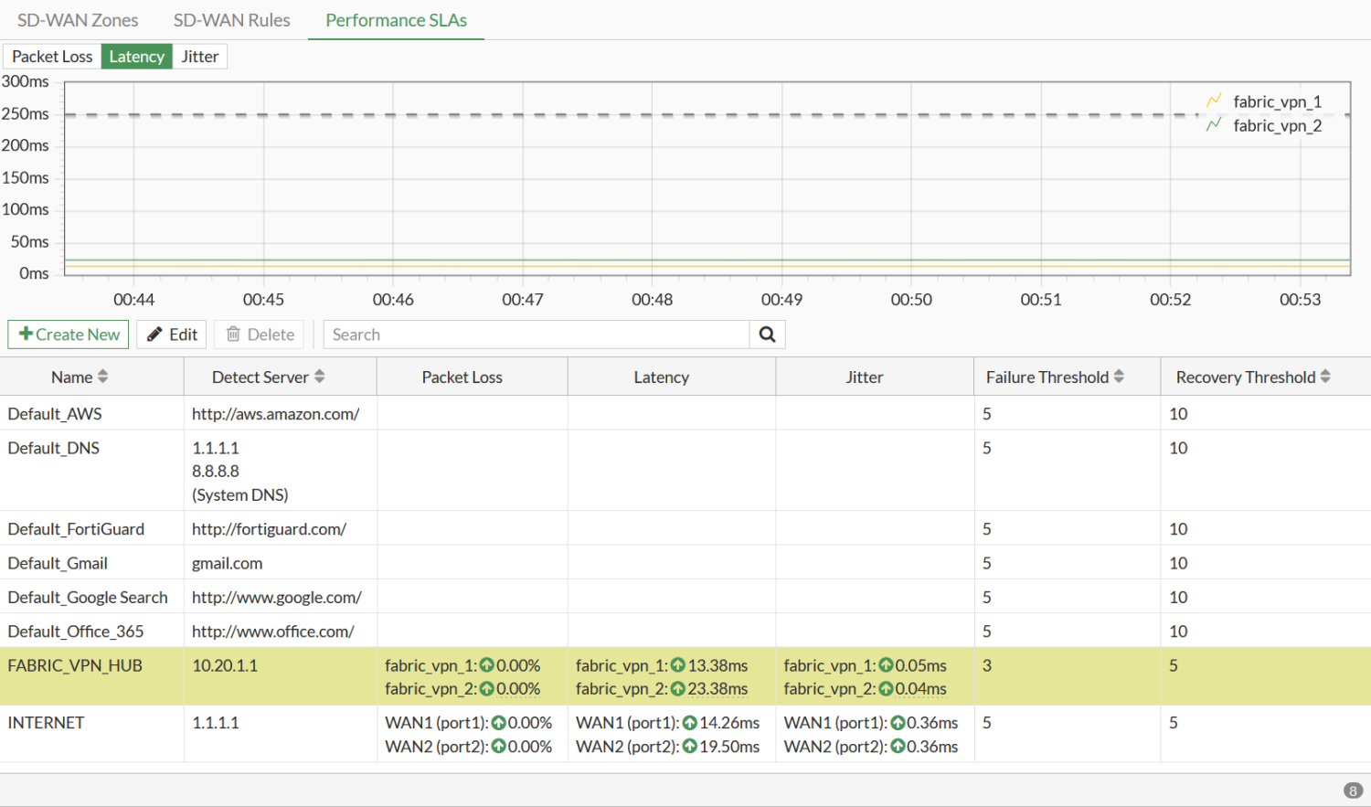

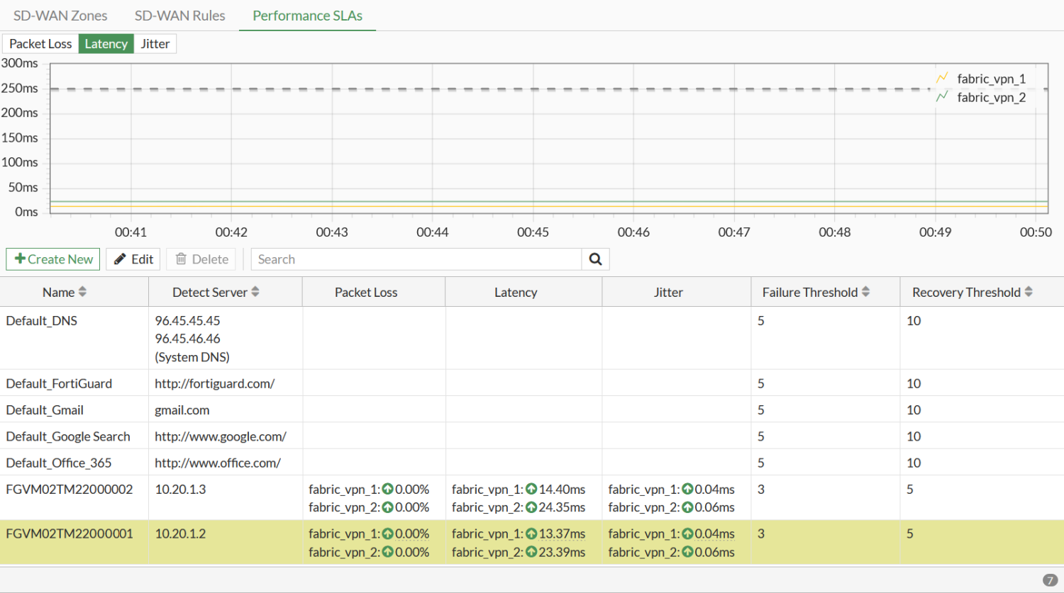

To verify the performance SLAs on the hub:
Go to Network > SD-WAN and select the Performance SLAs tab.
- Verify that the performance SLAs are automatically created for each spoke. The performance SLA naming uses the serial number of the spoke FortiGate. There are two new entries.
To verify the firewall policies on a spoke FortiGate:
Different policies are created on the spoke FortiGates based on the hub's Policy creation setting in the Fabric Overlay Orchestrator configuration (Automatic, Health check, or Manual). The Automatic setting is used in this example.
Go to Policy & Objects > Firewall Policy.
Verify that wildcard firewall policies have been configured.
If the hub's Policy creationsetting is Health Check, a single firewall policy that allows health check traffic to the spoke’s loopback should be configured on the spoke FortiGates:
If the hub's Policy creationsetting is Manual, there should be no new policies created by the Fabric Overlay Orchestrator. If desired, firewall policies must be manually configured on the spoke FortiGates to allow traffic to the loopback interface for health checks and the overlays.

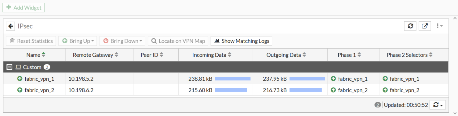

To verify the IPsec VPN tunnels on a spoke:
Verify the IPsec tunnels that go back to the hub.
To verify BGP routing on a spoke:
Branch1 # get router info bgp summary VRF 0 BGP router identifier 10.20.1.2, local AS number 65400 BGP table version is 5 1 BGP AS-PATH entries 0 BGP community entries Neighbor V AS MsgRcvd MsgSent TblVer InQ OutQ Up/Down State/PfxRcd 10.10.10.253 4 65400 41 37 4 0 0 00:23:39 8 10.10.11.253 4 65400 38 34 4 0 0 00:23:33 8 Total number of neighbors 2
Branch1 # get router info bgp neighbors 10.10.10.253 advertised-routes VRF 0 BGP table version is 5, local router ID is 10.20.1.2 Status codes: s suppressed, d damped, h history, * valid, > best, i - internal Origin codes: i - IGP, e - EGP, ? - incomplete Network Next Hop Metric LocPrf Weight RouteTag Path *>i10.1.1.0/24 10.10.10.1 100 32768 0 i <0/-> *>i10.20.1.2/32 10.10.10.1 100 32768 0 i <0/-> Total number of prefixes 2
To verify the performance SLAs on a spoke:
- Go to Network > SD-WAN and select the Performance SLAs tab.
- Verify that the performance SLA is automatically created for the hub FortiGate. There is a new entry (FABRIC_VPN_HUB).

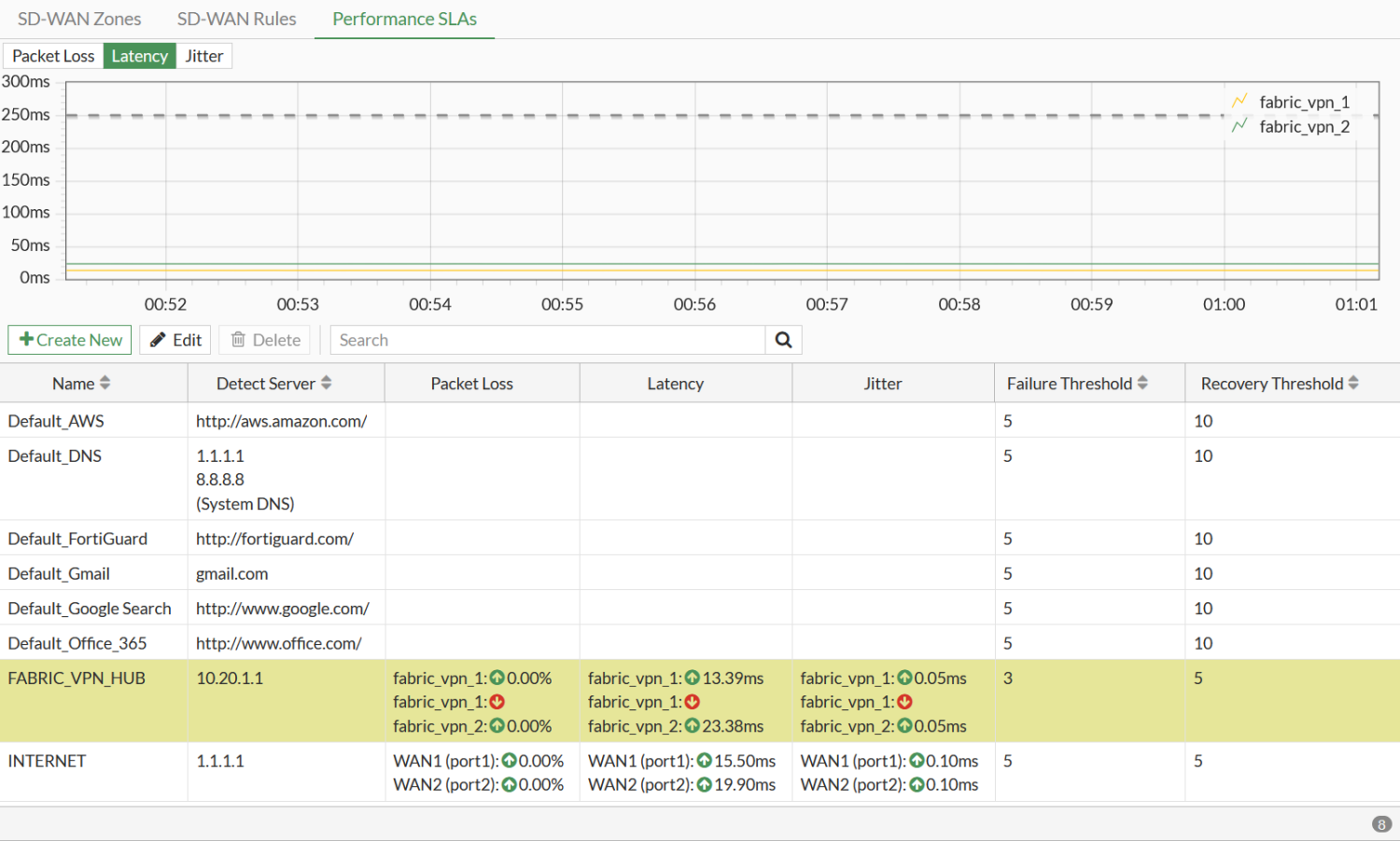

To verify the spoke-to-spoke ADVPN communication:
- From Branch1, ping Branch2 (10.20.1.3):
Branch1 # exec ping-options source 10.20.1.2 Branch1 # exec ping 10.20.1.3 PING 10.20.1.3 (10.20.1.3): 56 data bytes 64 bytes from 10.20.1.3: icmp_seq=0 ttl=254 time=27.7 ms 64 bytes from 10.20.1.3: icmp_seq=2 ttl=255 time=17.4 ms 64 bytes from 10.20.1.3: icmp_seq=3 ttl=255 time=17.5 ms 64 bytes from 10.20.1.3: icmp_seq=4 ttl=255 time=17.4 ms --- 10.20.1.3 ping statistics --- 5 packets transmitted, 4 packets received, 20% packet loss round-trip min/avg/max = 17.4/20.0/27.7 ms
- Verify the IPsec tunnel summary.
In the CLI, enter the following:
Branch1 # get vpn ipsec tunnel summary 'fabric_vpn_1_0' 10.198.3.2:0 selectors(total,up): 1/1 rx(pkt,err): 25/0 tx(pkt,err): 26/2 'fabric_vpn_1' 10.198.5.2:0 selectors(total,up): 1/1 rx(pkt,err): 8032/0 tx(pkt,err): 8022/2 'fabric_vpn_2' 10.198.6.2:0 selectors(total,up): 1/1 rx(pkt,err): 7462/0 tx(pkt,err): 7478/1
The
fabric_vpn_1_0tunnel was created for spoke 1-to-spoke 2 communication.In the GUI, go to Dashboard > Network and click the IPsec widget to expand it.
- Verify that the performance SLA was updated. Go to Network > SD-WAN and select the Performance SLAs tab.
The first performance SLA, fabric_vpn_1, that corresponds to the spoke-to-hub VPN tunnel is shown as up. The second one, fabric_vpn_1 that corresponds to the spoke-to-spoke VPN tunnel (fabric_vpn_1_0) is shown as down since 10.20.1.1 is the IP address corresponding to the hub’s loopback interface that is not present on another spoke.

Enter a name (such as LAN-to-HUB).
In the Source section, set the Address to the local subnet of the spoke.
Configure the following in the Destination section:
Set the Address to the local subnet of the hub. If an address object does not exist yet, click Create in the slide-out pane and configure the address.
Set the Protocol number as needed (default = ANY).
Configure the following in the Outgoing Interfaces section:
Set the Interface selection strategy to Lowest cost (SLA).
Set the Interface preference to the SD-WAN members.
Set Required SLA target to the corresponding performance SLA created by the Fabric Overlay Orchestrator, which is named FABRIC_VPN_HUB#1 by default.
Click OK.
