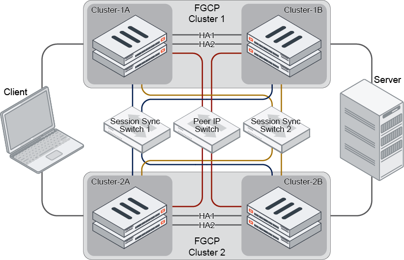

The following topology uses multiple session synchronization interfaces with a full mesh backbone to prevent any single point of failure.

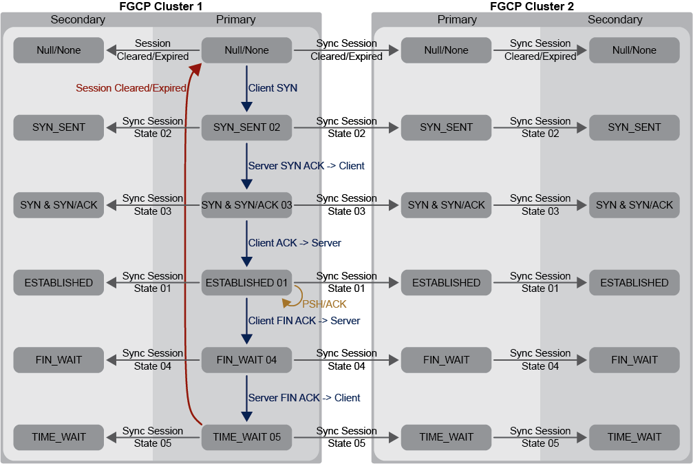

The state diagram summarizes the session synchronization of a TCP session. It assumes that the session is connected over FGCP Cluster 1 and processed entirely by the primary unit, Cluster-1A.
  1. The session starts with the Client SYN packet.
  2. As the session is established, Cluster-1A synchronizes the session with Cluster-1B over the heartbeat interface, and with Cluster-2A over the session synchronization interface.
  3. Cluster-2A then synchronizes the session with Cluster-2B over its heartbeat interface.
  4. The process then repeats as it transitions to different states.
Session synchronization if links fail
In the previous topology, if any single session synchronization link fails on the primary member of each cluster, session synchronization will continue on the second link from the pair of session of session synchronization interfaces.
If the second link on the primary member of the same cluster then fails, L2 session synchronization over the session synchronization interface stops, and synchronization fails over to L3 between the peer IP links.
If the Peer IP link then fails, the FGSP peers are effectively disconnected, and no session synchronization will occur.
