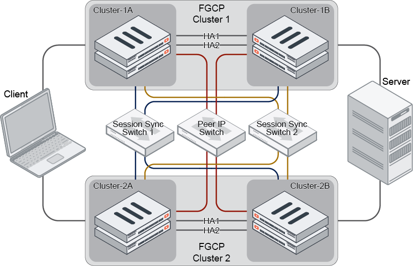

The following topology uses multiple session synchronization interfaces with a full mesh backbone to prevent any single point of failure.

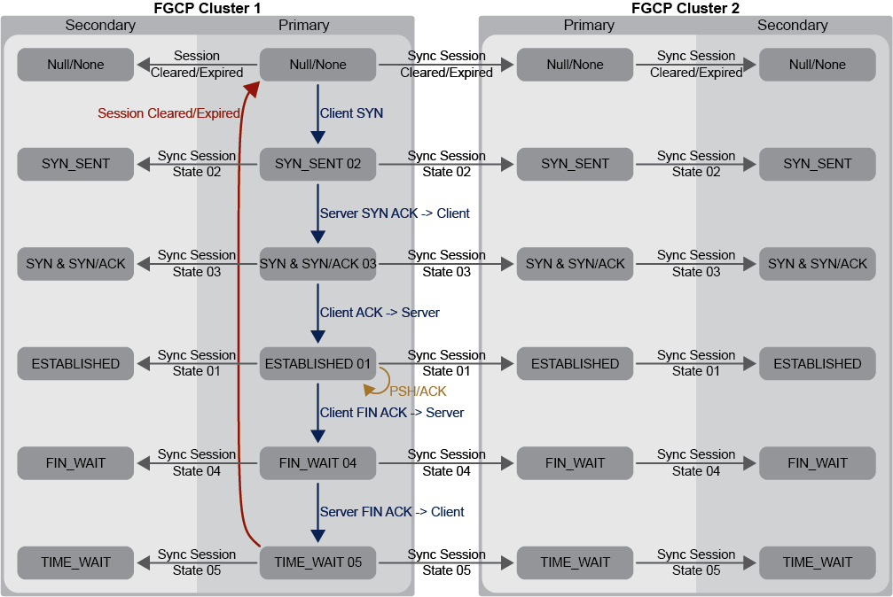

The state diagram summarizes the session synchronization of a TCP session. It assumes that the session is connected over FGCP Cluster 1 and processed entirely by the primary unit, Cluster-1A.
The session starts with the Client SYN packet.
As the session is established, Cluster-1A synchronizes the session with Cluster-1B over the heartbeat interface, and with Cluster-2A over the session synchronization interface.
Cluster-2A then synchronizes the session with Cluster-2B over its heartbeat interface.
The process then repeats as it transitions to different states.
