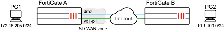

In this example, an IPsec tunnel is configured between two FortiGates that have FEC enabled and supporting configuration to protect traffic that egresses FortiGate A and ingresses FortiGate B. The tunnel is an SD-WAN zone, and an SLA health-check is used to monitor the quality of the VPN overlay. The intention is to apply FEC to UDP traffic that is passing through the VPN overlay, while allowing all other traffic to pass through without FEC. An FEC profile is configured to adaptively increase redundant levels if the link quality exceeds a 10% packet loss threshold, or the bandwidth exceeds 950 Mbps.
The DMZ interface and IPsec tunnel vd1-p1 are SD-WAN members. FEC is enabled on vd1-p1, and health-check works on vd1-p1.

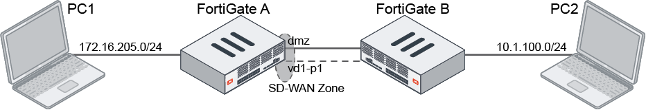

    npu_state=0x5040000
    no_ofld_reason:  non-npu-intf
    Non-FEC protected TCP traffic is offloaded, while FEC protected UDP traffic is not offloaded
  2. On FortiGate A, check the health-check result and the corresponding FEC base and redundant packets:
    # diagnose sys sdwan health-check
    Health Check(1):
    Seq(2 vd1-p1): state(alive), packet-loss(0.000%) latency(0.168), jitter(0.021), bandwidth-up(999999), bandwidth-dw(999998), bandwidth-bi(1999997) sla_map=0x1
    Because bandwidth-up is more than 950000kbps, base and redundant are set to 9 and 3:
    # diagnose vpn tunnel fec vd1-p1
    egress:
        enabled=1 base=9 redundant=3 codec=0 timeout=10(ms)
        encode=6621 encode_timeout=6621 encode_fail=0
        tx_data=6880 tx_parity=18601
    ingress:
        enabled=0 timeout=0(ms)
        fasm_cnt=0 fasm_full=0
        ipsec_fec_chk_fail=0 complete=0
        rx_data=0 rx_parity=0
        recover=0 recover_timeout=0 recover_fail=0
        rx=0 rx_fail=0
  3. Make packet loss more than 10%, then check the health-check result and the corresponding FEC base and redundant packets again on FortiGate A:
    Health Check(1):
    Seq(2 vd1-p1): state(alive), packet-loss(15.000%) latency(0.168), jitter(0.017), bandwidth-up(999999), bandwidth-dw(999998), bandwidth-bi(1999997) sla_map=0x0
    Because packet loss is more than 10%, entry one in FEC mapping is first matched, and base and redundant are set to 8 and 2:
    egress:
        enabled=1 base=8 redundant=2 codec=0 timeout=10(ms)
        encode=6670 encode_timeout=6670 encode_fail=0
        tx_data=6976 tx_parity=18748
    ingress:
        rx=0 rx_fail=0
