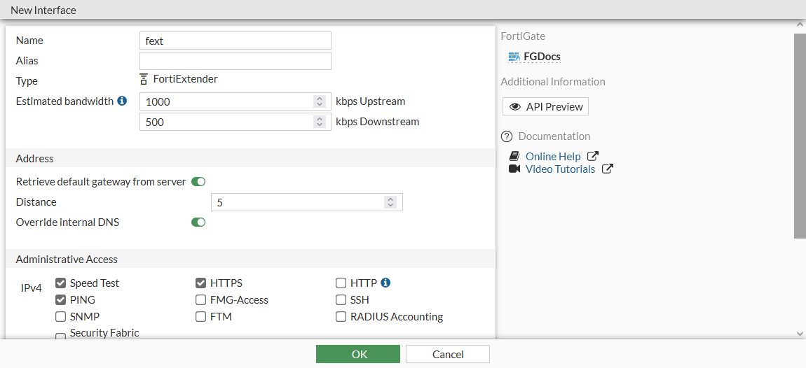

To add a FortiExtender to the FortiGate, create a virtual FortiExtender interface, then add a FortiExtender and assign the interface to the modem. Like other interface types, the FortiExtender interface can be used in static routes, SD-WAN (see Manage dual FortiExtender devices), policies, and other functions.
To create a virtual FortiExtender interface in the GUI:
  1. Go to Network > Interfaces and click Create New > FortiExtender.
  2. Enter a name for the interface.
  3. Configure the remaining settings as needed. See Interface settings for more details.
  4. Click OK.

To create a virtual FortiExtender interface in the CLI:
config system interface
    edit "fext"
        set vdom "root"
        set mode dhcp
        set allowaccess ping https speed-test
        set type fext-wan
        set estimated-upstream-bandwidth 1000
        set estimated-downstream-bandwidth 500
