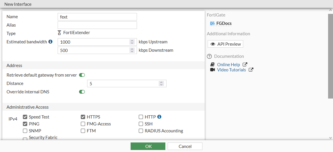

To create a virtual FortiExtender interface in the GUI:
  1. Go to Network > Interfaces and click Create New > FortiExtender.
  2. Enter a name for the interface.
  3. Configure the remaining settings as needed. See Interface settings for more details.
  4. Click OK.

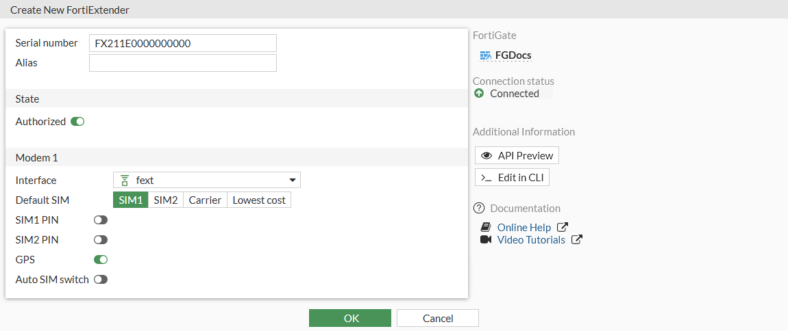

To add a FortiExtender in the GUI:
  1. Go to Network > FortiExtender and click Create New > Extenders.
  2. Enter your FortiExtender's serial number in the Serial number field.
  3. Optionally, set an Alias for the FortiExtender.
  4. In the State section, enable Authorized.
  5. Set Interface to the FortiExtender interface.
  6. Configure the remaining setting as required. See the FortiExtender Administration Guide (FGT-Managed) for more information.
  7. Click OK.
  8. In the extenders list, right-click on the FortiExtender and select Diagnostics and Tools to review the modem and SIM status, and other details about the FortiExtender.
To create a virtual FortiExtender interface in the CLI:
config system interface
    edit "fext"
        set vdom "root"
        set mode dhcp
        set allowaccess ping https speed-test
        set type fext-wan
        set estimated-upstream-bandwidth 1000
        set estimated-downstream-bandwidth 500
To configure the FortiExtender in the CLI:
config extender-controller extender
    edit "FX211E"
        set id "FX211E0000000000"
        set authorized enable
        config modem1
            set ifname "fext"
  4. Click OK.
  7. Click OK.
    edit "fext"
        set vdom "root"
        set mode dhcp
        set type fext-wan
    edit "FX211E"
        config modem1
            set ifname "fext"
