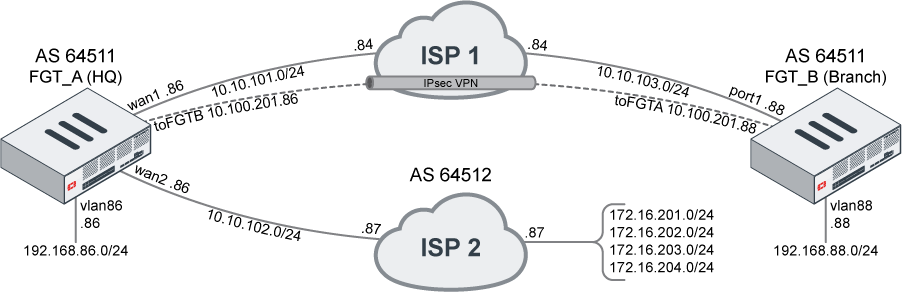

In this example, BGP is configured on two FortiGate devices. The FortiGates are geographically separated, and form iBGP peering over a VPN connection. FGT_A also forms eBGP peering with ISP2.
FGT_A learns routes from ISP2 and redistributes them to FGT_B while preventing any iBGP routes from being advertised.
The internal networks behind the FortiGates can communicate with each other, and the internal networks behind FGT_B can traverse FGT_A to reach networks that are advertised by ISP2.
  • FGT_A and FGT_B have static routes to each other through ISP1. ISP1 does not participate in BGP.
  • The IPsec VPN tunnel between FGT_A and FGT_B is configured with wildcard 0.0.0.0/0 networks for phase2 local and remote selectors. The VPN interfaces have IP addresses already configured and are used for peering between FGT_A and FGT_B.
  • FGT_A is configure to peer with ISP2 on 10.10.108.86.
  • The firewall policies between FGT_A and FGT_B are not NATed. The firewall policies egressing on wan2 are NATed.

Basic BGP example
