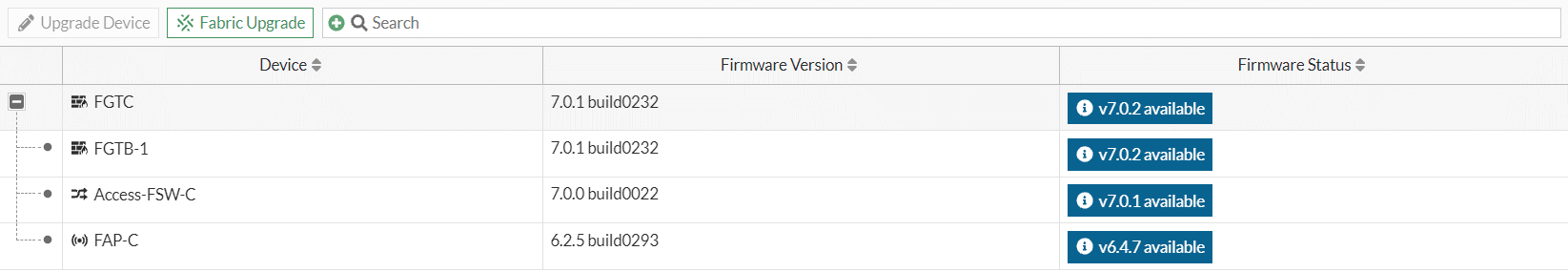

- Go to System > Fabric Management. The devices are displayed in the table with their firmware version and status. In this example, all devices (root FortiGate, downstream FortiGate, FortiSwitch, and FortiAP) have an upgrade available.

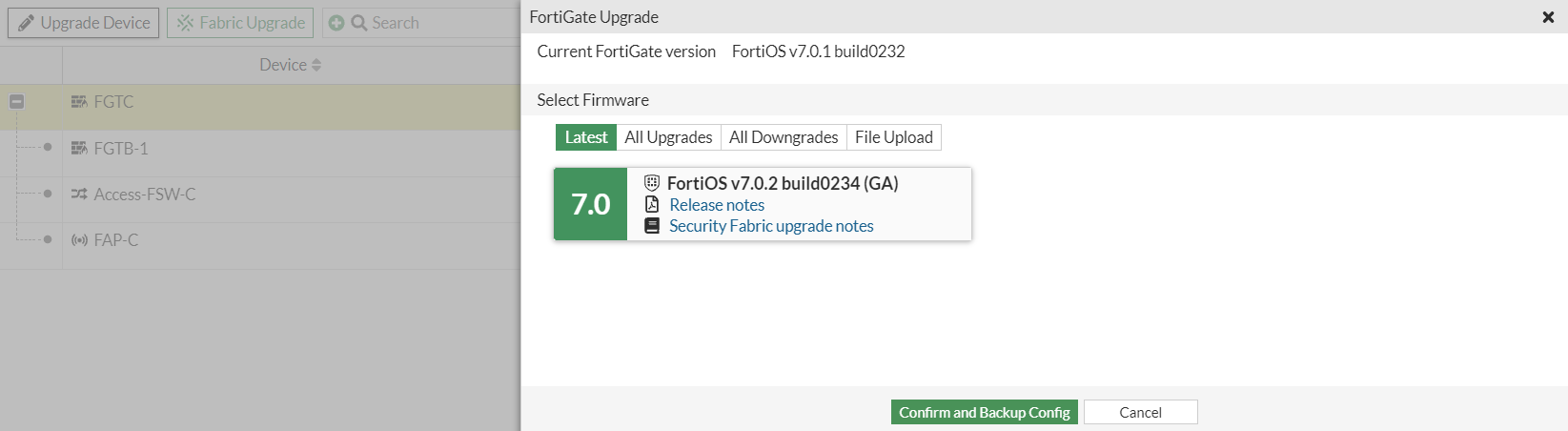

- Select the device (FGTC) and click Upgrade Device. The FortiGate Upgrade pane opens.
- Select Latest (other options available are All Upgrades, All Downgrades, and File Upload) and select the option that is displayed.
- Click Confirm and Backup Config then click Continue to initiate the upgrade.

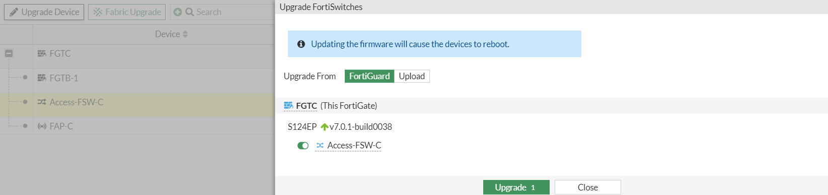

- Go to System > Fabric Management and select the device (Access-FSW-C), then click Upgrade Device. The Upgrade FortiSwitches pane opens.
- Select FortiGuard, ensure the device you want to upgrade is enabled, then click Upgrade.

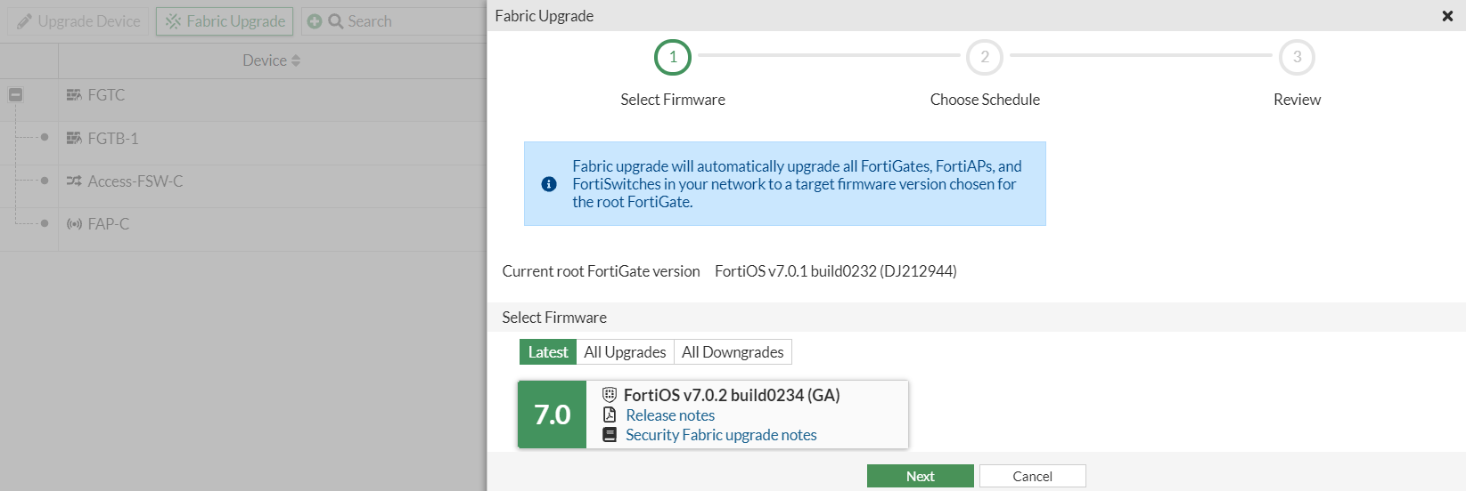

To upgrade all Fabric device firmware:
- Go to System > Fabric Management and click Fabric Upgrade. The Fabric Upgrade pane opens.
- Select Latest and select the option that is displayed, then click Next.

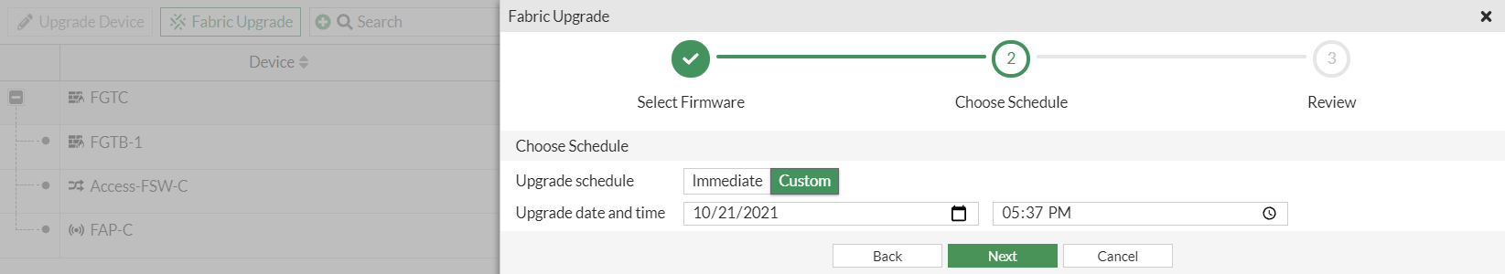

- Select an upgrade schedule, either Immediate or Custom. If using Custom, enter an upgrade date and time (Custom is used in this example).
In a custom upgrade, the configuration backups are saved when the administrator schedules the upgrade. If the scheduled upgrade occurs after further configuration changes are made, the latest changes will not be saved in a new backup configuration file.

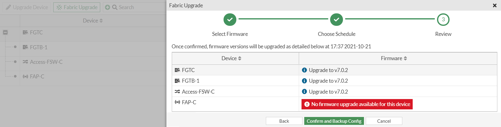

- Click Next and review the update schedule. For the FortiAP, a message appears because a firmware upgrade is currently not available.

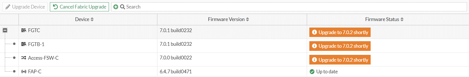

- Click Confirm and Backup Config. The pane goes into a loading state to wait for all FortiGate configurations to save. Once completed, the pane closes and the device list refreshes to reflect the latest changes.
