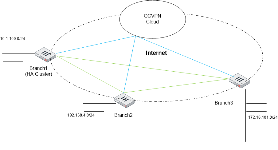

Sample topology
The following example shows three FortiGate units registered on FortiCare using the same FortiCare account. Each FortiGate unit has one internal subnet, and no NAT exists between the units.
Sample configuration
The following overlays and subnets are used:
- Branch1:
- Overlay name: QA. Local subnets: 10.1.100.0/24
- Overlay name: PM. Local subnets: 10.2.100.0/24
- Branch2:
- Overlay name: QA. Local interfaces: lan1
- Overlay name: PM. Local interfaces: lan2
- Branch3:
- Overlay name: QA. Local subnets: 172.16.101.0/24
- Overlay name: PM. Local subnets: 172.16.102.0/24

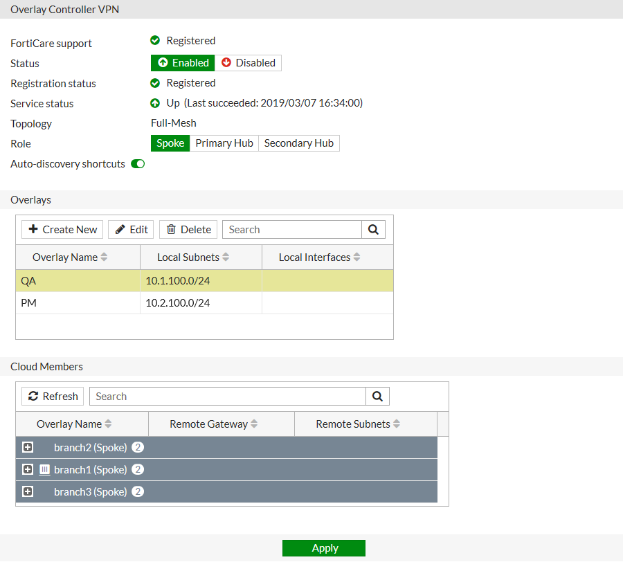

To enable OCVPN in the GUI:
- Go to VPN > Overlay Controller VPN.
- Create the first overlay by setting the following options:
- For Status, click Enabled.
- For Role, click Spoke.

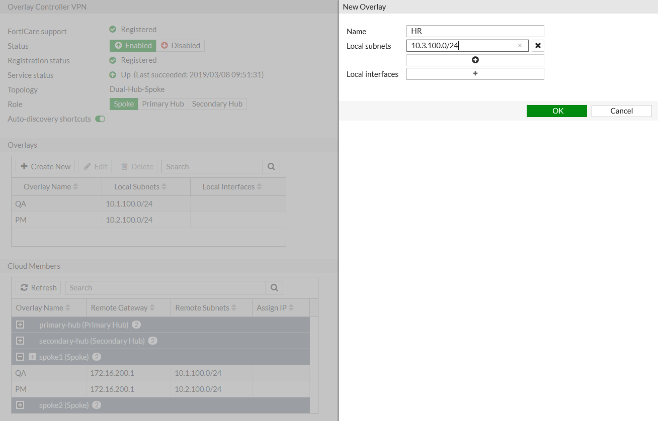

- In the Overlays section, click Create New to create a network overlay.
- Specify the Name, Local subnets, and/or Local interfaces.
The local subnet must be routable and interfaces must have IP addresses.
- Click OK.
- Click Apply to commit the configuration.
- Repeat this procedure to create all the overlays.
