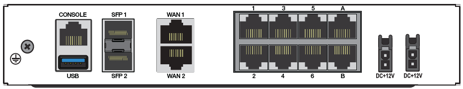

Use one Ethernet cable to connect the management port on the FortiGate to a management computer.
The default interface used for management differs from model to model. On most units with a single dedicated management port, the port is named MGMT. On units with multiple management ports, the names MGMT1 and MGMT2 are used. On units without dedicated management ports, port1 is used for initial management access, and the port can be part of a virtual switch group.
The following example is for a FortiGate 80F, which uses port1 for initial management access. For information about your FortiGate hardware model, go to FortiGate/FortiOS Hardware Guides.
Use a second Ethernet cable to connect the WAN on the FortiGate to an upstream router, switch, or modem with access to the internet.
On some FortiGate models, dedicated WAN interface(s) labeled WAN1, WAN2, and so on are available. If no dedicated WAN interfaces are present, select an interface of your choice for the WAN connection.
Internet access is available when the FortiGate model has addressing mode set to DHCP by default on the WAN interface, and the WAN interface is connected to a network with a DHCP server assigning the correct IP and gateway for internet access. If these conditions are not met, then internet access is not available after connecting your WAN interface. See .
