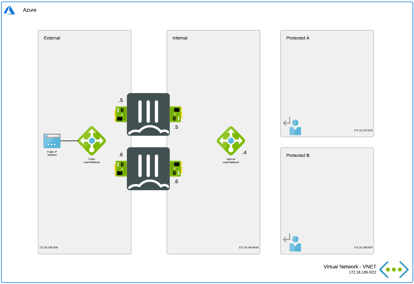

Active-passive with external and internal Azure load balancer: This design deploys two FortiGate-VMs in active-passive mode connected using Unicast FGCP HA protocol. In this setup, the Azure load balancer handles traffic failover using a health probe towards the FortiGate-VMs. The failover times are based on the health probe of the Azure load balancer: 2 failed attempts per 5 seconds with a maximum of 15 seconds. The public IP addresses are configured on the Azure load balancer and provide ingress and egress flows with inspection from the FortiGate. Microsoft provides guidance on this architecture.

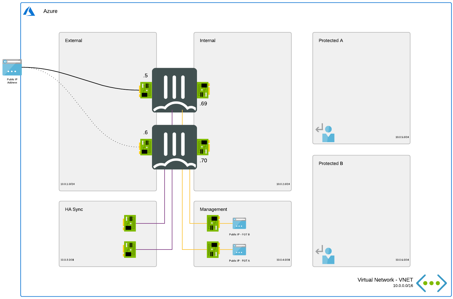

Active-passive HA with SDN connector failover: This design deploys two FortiGate-VMs in active-passive mode connected using the Unicast FGCP HA protocol. This protocol synchronizes the configuration. On failover, the passive FortiGate takes control and issues API calls to Azure to shift the public IP address and update the internal user-defined routing to itself. Shifting the public IP address and gateway IP addresses of the routes takes time for Azure to complete. Microsoft provides a general architecture. In FortiGate's case, the API calls logic is built-in instead of requiring additional outside logic like Azure Functions or ZooKeeper nodes.
Active-active with external and internal Azure load balancer:This design deploys two FortiGate-VMs in active-active as two independent systems. In this setup, the Azure load balancer handles traffic failover using a health probe towards the FortiGate-VMs. The public IP addresses are configured on the Azure load balancer and provide ingress and egress flows with inspection from the FortiGate. You can use a FortiManager or local replication to synchronize configuration in this setup. Microsoft provides guidance on this architecture.

In active-passive HA scenarios on Azure, you must set the physical interface IP address (port1) and local tunnel interface IP addresses manually on the secondary FortiGate. HA does not automatically sync these IP addresses. You must also manually copy loopback interface configuration from the HA primary to the secondary FortiGate. Configuring a VDOM exception for "system.interface" does not affect behavior. |
