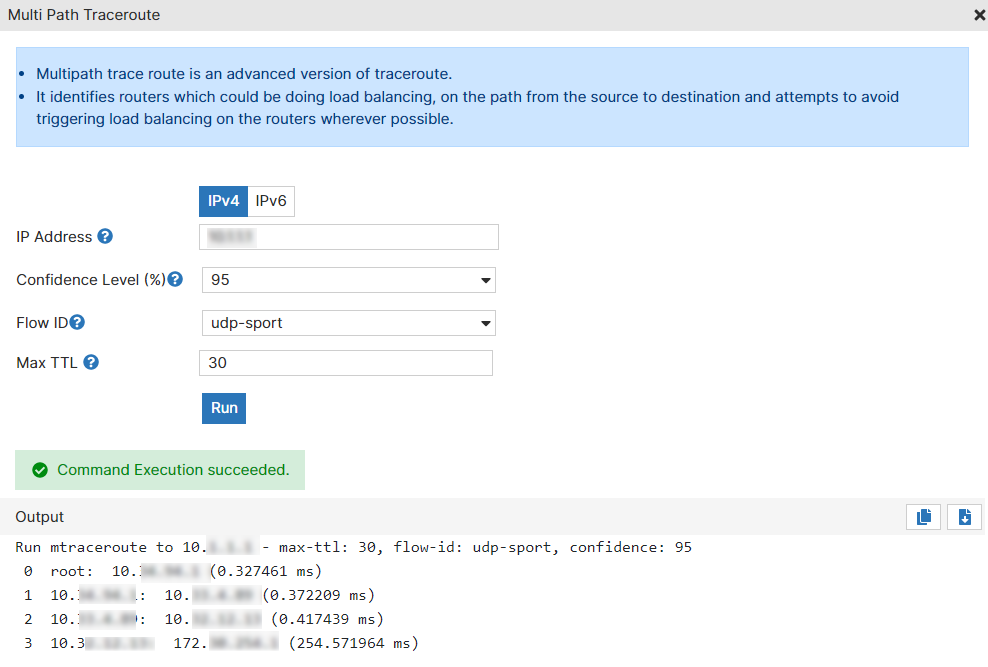

This is an advanced version of traceroute that identifies routers which could be load balancing on the path from the source to destination. It attempts to avoid triggering load balancing on the routers, wherever possible. Update the following configuration for IPv4/IPv6.
  • IP Address - The IP address or host name to trace the route to.
  • Confidence Level (%) – Select the confidence level. The allowed values are 90, 95, and 99, the default is 95.
  • Flow ID – Select the flow identifier.
  • Max TTL - The maximum time-to-live (number of hops) used in outgoing probe packets. The valid range is 1 – 255 and the default is 30.
