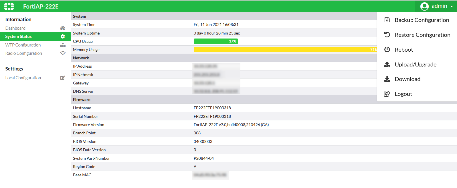

    4. Log in to the FortiAP UI as admin. Leave the Password field empty.
    5. In the Status section, go to Firmware Version and click Update.
    6. Follow the on-screen instructions to load and apply the firmware file.
    7. When you see the message "Uploading file is done. Firmware updating.", click OK, and close the web browser.

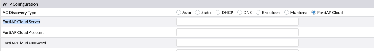

    8. After the upgrade is complete, start a web browser and connect to https://192.168.1.2.
    9. In the WTP Configuration section, go to AC Discovery Type and select FortiAP Cloud.
    10. Type the name and password of your FortiEdge Cloud account.
    11. Click Apply.
    11. Click Apply.
