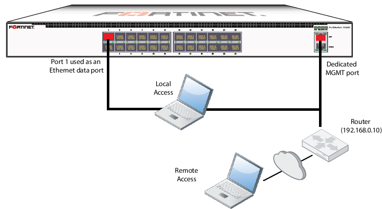

In this example, an out-of-band management interface is used as the dedicated management port. You can configure the management port for local or remote access.
Out-of-band management on a FortiSwitch-1024D
Option 1: management port with static IP
config system interface
edit mgmt
set mode static
set ip 10.105.142.19 255.255.255.0
set allowaccess ping https http ssh snmp telnet
set type physical
edit internal
set type physical
// optional configuration to allow remote access to the management port
config router static
set device mgmt
set gateway 192.168.0.10
set status enable
Option 2: management port with IP assigned by DHCP
edit mgmt
set mode dhcp
set defaultgw enable // allows remote access
set type physical
edit internal
set type physical
edit mgmt
set mode static
set type physical
edit internal
set type physical
set device mgmt
set status enable
edit mgmt
set mode dhcp
set type physical
edit internal
set type physical
