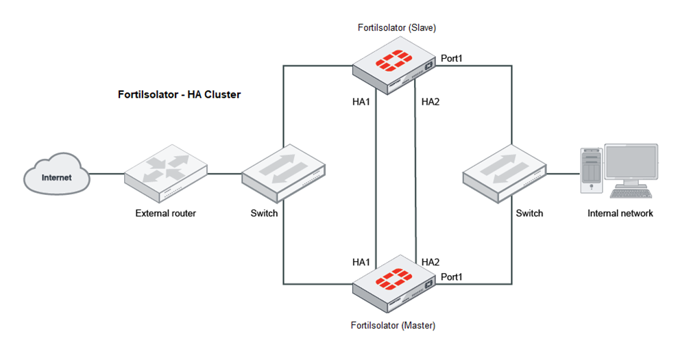

FortiIsolator provides an HA solution whereby FortiIsolator can find other member FortiIsolators to negotiate and create a cluster, which consists of 2 to 255 FortiIsolator members/nodes configured for HA operation. The cluster works like a device but always has a hot backup device.
Configuration
The nodes in the cluster do not have to be the same model (e.g. FIS 1000F, KVM, or ESXi) and their IP addresses can vary. However, the same firmware must be installed on all nodes and some HA setting (bold in table below) must be the same.

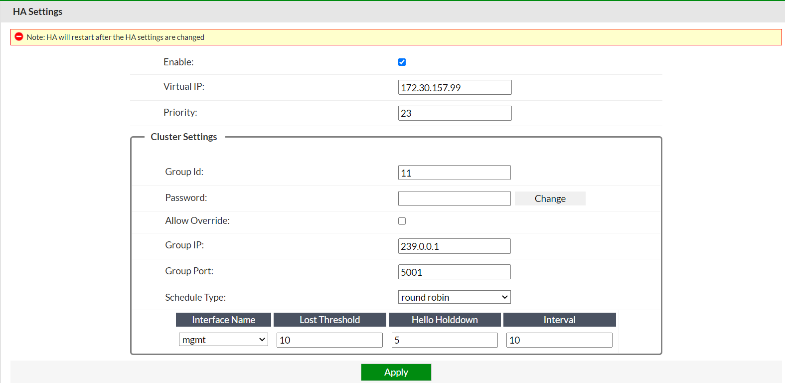

Under System > HA, configure the following options.
Parameter
Enable
Specifies whether to enable HA mode for this node.
Virtual IP
IP for web browsers access from all nodes in the cluster. Only the primary device has virtual IP address, which is shared among all nodes within the cluster so all nodes can use this same virtual IP address to access sites. The virtual IP address must be the same subnet as the internal interface.
In HA mode, web browsers access the virtual IP address in the following modes:
  • IP Forwarding—The web browser first connects to the virtual IP address of the primary node which then forwards the request to itself or another node in the cluster through the internal IP of the recipient node in the cluster, which can be the primary node itself or a secondary node.
  • Proxy—The web browser connects to the virtual IP address of the primary node and keeps communicating with the primary node, which then connects to a node (can be the primary node itself) on its internal IP through web socket connection. The web browser then runs the session on that node.
Priority
Priority of the node indicated with an integer between 0 to 254, where 0 means the highest priority.
You must assign a unique priority ID to each node. The node with the highest priority ID automatically becomes the primary device of the HA cluster.
Group Id
A unique number to identify the cluster. One Group ID number represents one cluster, while different Group ID numbers represent different clusters. Group ID must be an integer between 1 – 255.
Password
Password for the group, which protects the cluster from unauthorized access.
Allow Override
Specifies whether to allow other nodes to override as a primary node when this node is primary. This option does not take effect when the node is secondary.
Group IP
IP multicast in the range of 224.0.0.0 and 239.255.255.255.
Group Port
Port of the group IP address.
Schedule Type
  • round robin—Send URL requests can to all member nodes in circular order one by one. All handlings have equal priority.
  • weighted round robin: Round robin scheduling with a fixed number as configured weight which allows member nodes to deal with more than one URL requests in one circular order.
Interface Name
Name of the network interface for network traffic, such as the heartbeats to detect whether the member nodes are alive, and communication among all member nodes within the cluster.
Lost Threshold
Maximum number of successive heartbeat packets that can be missed from other nodes within the cluster. The HA cluster fails as soon as the number of successive missing packets exceeds Lost Threshold.
Hello Holddown
Duration (in seconds) of the transition from HA in Hello state to HA in work state. This parameter accepts integers between 5 - 300.
Interval
Duration (in seconds) between two successive packets.
