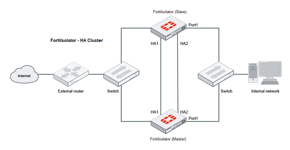

High availability (HA) is usually required in a system where there is high demand for little downtime. There are usually hot-swaps, backup routes, or standby backup units and as soon as the active entity fails, backup entities will start functioning. This results in minimal interruption for the users.
FortiIsolator provides an HA solution whereby FortiIsolator can find other member FortiIsolators to negotiate and create a cluster. A FortiIsolator HA cluster consists of at least two FortiIsolator (members) configured for HA operation. All FortiIsolators in the cluster do not need to be the same model (e.g. FIS 1000F, KVM, or ESXi), but they have to had the same firmware installed. Cluster members must have the same configuration, except for their IP address and priority in the HA settings. The cluster works like a device but always has a hot backup device.

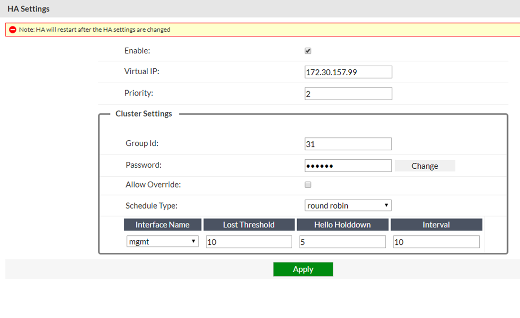

How it works
FortiIsolator allows each HA cluster to have up to 255 HA nodes. Each node must have the same settings for:
Parameter
Virtual IP The virtual IP address to be shared among all member nodes within a cluster; so all member nodes can use this same virtual IP address to access sites.
Group ID A unique number to identify a cluster. One Group ID number represents one cluster, while different Group ID numbers represent different clusters. Group ID must be an integer between 1 – 255.
Password Password pairs with Group ID, allowing users to protect their own cluster from unauthorized parties. All member nodes within the same cluster, where they have the same Group ID, must enter the same password among all member nodes.

Interface Name The network interface is for network traffics and communications among all member nodes within a same cluster; the traffics such as the heartbeats to detect whether the member nodes are alive.
Lost Threshold Maximum limitation that HA cluster can allow how many successive heartbeat packets miss from other cluster. HA cluster fails as soon as the number of successive missing packets are more than lost threshold.
Hello Holddown
Time slot (unit is second) between transition from HA in Hello state to HA in work state.
Interval
Time slot between sending two successive packets.

FortiIsolator uses HA interface/port for database synchronization and heartbeat. HA interface/port is designed for better performance purpose, but it can choose other interface/port as well.
The VIP address will be put on interface, so it has to be the same subnet as internal interface. This is the IP for the web browsers access. Only the master device has VIP.

The following is an example of an HA Cluster setup.
To configure HA (Slave) from CLI:
set ha-enabled 1
set ha-virtual-ip 172.30.157.99
set ha-priority 2
set ha-group-id 31
set ha-interface mgmt
set ha-password password

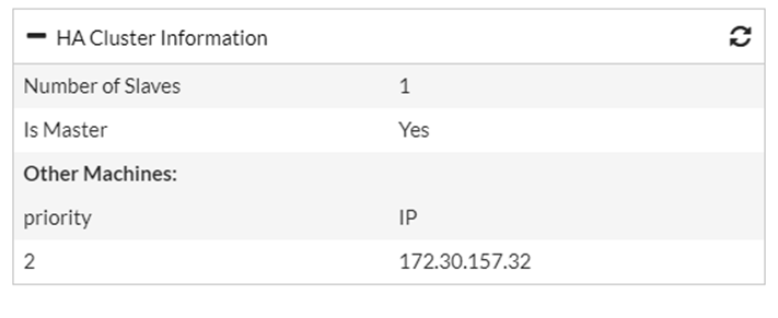

Verify HA Cluster Information in Master node from GUI - Dashboard:
Verify HA Cluster Information in Master node from CLI:

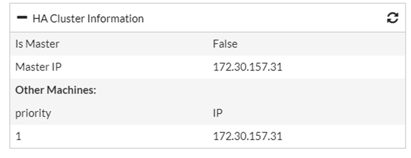

Verify HA Cluster Information in Slave node from GUI - Dashboard:
Verify HA Cluster Information in Slave node from CLI:

How it works
Parameter
Hello Holddown
Interval
set ha-enabled 1
set ha-priority 2
set ha-group-id 31
