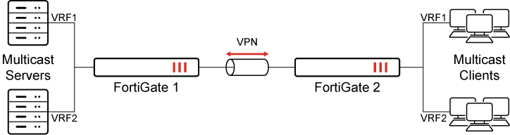

In this example, the multicast server:
  • Sends out multicast traffic ff0e::10 from 2000:172:16:205::11 in VRF1.
  • Sends out multicast traffic ff0e::20 from 2000:172:16:205::22 in VRF2.

To configure PIM-SM global settings for each VRF:
config router multicast6
    set multicast-routing enable
    config interface
        edit "vd3-1"
        edit "vd3-vlan33"
        edit "vd3-vlan331"
    config pim-sm-global-vrf
            config rp-address
                    set ip6-address 2011::12
            config rp-address
                    set ip6-address 2011::11
For brevity, only the commands relevant to this enhancement are included.
To verify VRF in IPv6 multicast routing:
  1. Review the sniffer information:
    • The VRF1 client can receive ff0e::10 and cannot receive ff0e::20:
      0.800190 npu0_vlink0 out 2000:172:16:205::11.33372 -> ff0e::10.5001: udp 46 [flowlabel 0xa620f]
      0.800197 vd33-vlan33 in 2000:172:16:205::11.33372 -> ff0e::10.5001: udp 46 [flowlabel 0xa620f]
    • The VRF2 client can receive ff0e::20 and cannot receive ff0e::10:
      0.666623 vd3-vlan331 out 2000:172:16:205::22.33372 -> ff0e::20.5001: udp 46 [flowlabel 0xa620f
      0.666630 vd3-vlan331 out 2000:172:16:205::22.33372 -> ff0e::20.5001: udp 46 [flowlabel 0xa620f
  2. Review the group information:
    # get router info6 multicast mld groups
    MLD Connected Group Membership
    VRF Group Address                           Interface            Uptime   Expires  Last Reporter
    1   ff0e::10                                vd3-vlan33           00:21:05 now(static) ::
    2   ff0e::20                                vd3-vlan331          00:21:05 now(static) ::
