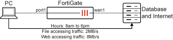

This example shows how to apply interface-based traffic shaping to web and file accessing traffic according to a schedule:
  • The link speed of the wan1 interface is 10 Mb/s.
  • File access can use up to 2 Mb/s from 8:00 AM to 6:00 PM.
  • Web access can use 8 Mb/s from 8:00 AM to 6:00 PM.

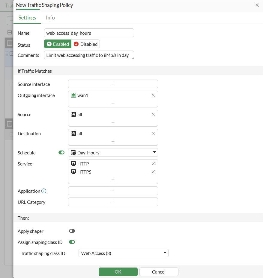

To create a traffic shaping policy and class ID for the web accessing traffic in the GUI:
  1. Go to Policy & Objects > Traffic Shaping, select the Traffic Shaping Policy tab, and click Create New.
  2. Enter a name for the policy, such as web_access_day_hours.
  3. Set Outgoing interface to wan1.
  4. Enable Schedule and select the schedule you just created.
  5. Set Service to web accessing services, such as HTTP and HTTPS.
  6. Enable Assign shaping class ID.
  7. Click the Traffic shaping class ID drop down then click Create.
  8. Enter an integer value for the ID (3) and a description for the Name, such as Web Access.
  9. Click OK.
  10. Select the class ID you just created for Traffic shaping class ID.
  11. Configure the remaining settings as required.
  12. Click OK.

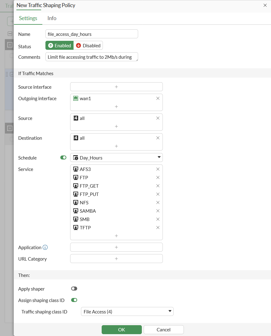

To create a traffic shaping policy and class ID for the file accessing traffic in the GUI:
  2. Enter a name for the policy, such as file_access_day_hours.
  5. Set Service to file accessing services, such as ASF3, FTP and SMB.
  8. Enter an integer value for the ID (4) and a description for the Name, such as File Access.
  9. Click OK.
  12. Click OK.

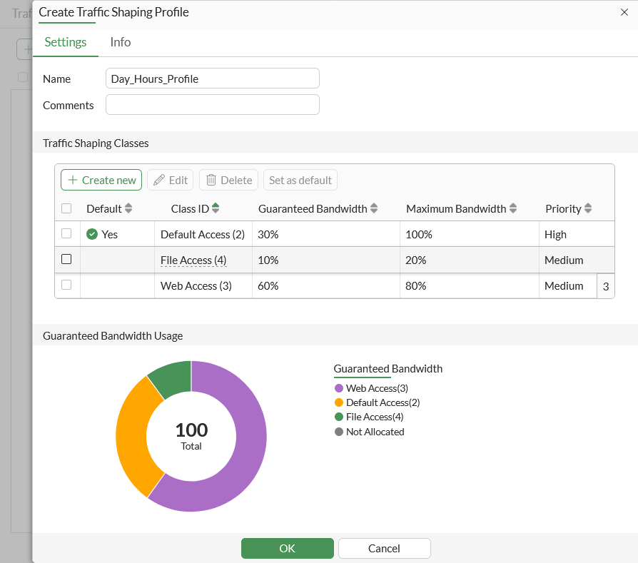

To create a traffic shaping profile using the GUI:
  1. Go to Policy & Objects > Traffic Shaping, select the Traffic Shaping Profile tab, and click Create New.
  2. Enter a name for the profile, such as Day_Hours_Profile.

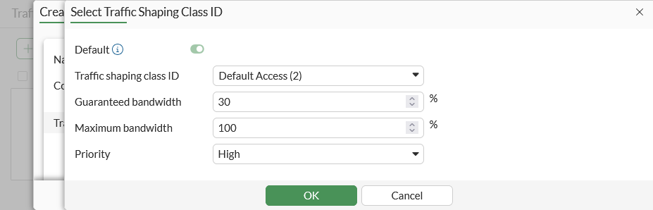

  3. Configure a default traffic shaping class:
    This class has a high priority, meaning that when the other classes have reached their guaranteed bandwidths, this default class will use the rest of the available bandwidth.
    1. In the Traffic Shaping Classes table click Create New.
    2. Click the Traffic shaping class ID drop down then click Create.
    3. Enter a name for the class, such as Default Access.
    4. Click OK.
    5. Select the class ID you just created for Traffic shaping class ID.
    6. Configure the following settings, then click OK:
      Guaranteed bandwidth
      30
      Maximum bandwidth
      100
      Priority
      High
  4. Configure a web accessing traffic shaping class:
    When other types of traffic are competing for bandwidth, this class is guaranteed to 6 Mb/s, or 60% of the bandwidth.
    2. Configure the following settings, then click OK:
      Web Access
      60
      Maximum bandwidth
      80
      Priority
      Medium
  5. Configure a file accessing traffic shaping class:
    When other types of traffic are competing for bandwidth, this group is guaranteed to 1 Mb/s, or 10% of the bandwidth.
      File Access
      10
      Maximum bandwidth
      20
      Priority
      Medium
  6. Click OK.

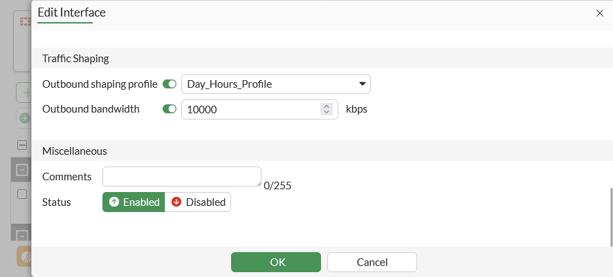

To set the bandwidth of the wan1 interface in the GUI:
  1. Go to Network > Interfaces.
  2. Edit the wan1 interface.
  3. Under Traffic Shaping, enable Outbound shaping profile and select the profile that you just created, Day_Hours_Profile.
  4. Enable Outbound Bandwidth and set it to 10000 Kbps.
  5. Click OK.
  9. Click OK.
  12. Click OK.
  9. Click OK.
  12. Click OK.
    4. Click OK.
      30
      Maximum bandwidth
      100
      Priority
      High
      Web Access
      60
      Maximum bandwidth
      80
      Priority
      Medium
      File Access
      10
      Maximum bandwidth
      20
      Priority
      Medium
  6. Click OK.
  5. Click OK.
