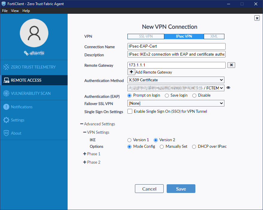

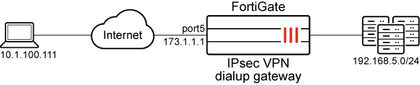

In this example, FortiClient is configured to use an X.509 certificate and EAP to perform certificate and user authentication. The certificate is issued by a CA that is trusted by the FortiGate.
To configure FortiClient:
  1. Go to Remote Access, click the sandwich menu, and select Add a new connection.
  2. Configure the new VPN connection.
    Field
    Value
    VPN
    IPsec VPN
    Connection Name
    IPsec-EAP-Cert
    (Optional)
    Remote Gateway
    173.1.1.1
    Authentication Method
    X.509 Certificate
    Authentication (EAP)
    Prompt on login
    Failover SSL VPN
    [None]
    Advanced Settings > VPN Settings
    IKE
    Version 2
    Options
    Mode Config
  3. Click Save.

The FortiGate will validate the client certificate based on the eap-cert-auth setting. The following examples show different outcomes from different configuration scenarios.
Scenario 1: eap-cert-auth is enabled and FortiGate receives a valid and trusted certificate
Using IKE debugs, we can observe the steps when FortiGate receives the connection request with the client certificate, validates it, and continues to perform EAP authentication before establishing the VPN connection.
# diagnose debug application ike -1
# diagnose debug enable
ike V=root:0:fct-eapcert:11: received FCT-UID : 4E98BCE511844FA8B161FA5DF047B12C
ike V=root:0:fct-eapcert:11: received peer identifier DER_ASN1_DN 'C = CA, ST = BC, L = Burnaby, O = Fortinet, OU = QA, CN = test3'
ike V=root:0:fct-eapcert:11: re-validate gw ID
ike V=root:0:fct-eapcert:11: gw validation OK
ike V=root:0:fct-eapcert:11: Validating X.509 certificate
ike V=root:0:fct-eapcert:11: peer cert, subject='test3', issuer='Eternity-CA'
ike V=root:0:fct-eapcert:11: peer ID verified
ike V=root:0:fct-eapcert:11: building fnbam peer candidate list
ike V=root:0:fct-eapcert:11: FNBAM_GROUP_NAME candidate 'peer-test3'
ike V=root:0:fct-eapcert:11: certificate validation before eap pending
ike V=root:0:fct-eapcert:11: fnbam reply 'peer-test3'
ike V=root:0:fct-eapcert:11: certificate validation complete
ike V=root:0:fct-eapcert:11: responder preparing EAP identity request
ike V=root:0:fct-eapcert:11: local cert, subject='test1', issuer='Eternity-CA'
ike 0:fct-eapcert:11: enc
ike V=root:0:fct-eapcert:11: sent IKE msg (AUTH_RESPONSE): 173.1.1.1:500->10.1.100.111:500, len=1420, vrf=0, id=e955507be9a857eb/b48a41c47db35bdb:00000001, oif=13
ike V=root:0: comes 10.1.100.111:500->173.1.1.1:500,ifindex=13,vrf=0,len=92....
ike V=root:0:fct-eapcert:11: responder received EAP msg
ike V=root:0:fct-eapcert:11: send EAP message to FNBAM
ike V=root:0:fct-eapcert:11: initiating EAP authentication
ike V=root:0:fct-eapcert: EAP user "bi_local"
ike V=root:0:fct-eapcert: auth group local-group
ike V=root:0:fct-eapcert: EAP 1600011514 pending
ike V=root:0:fct-eapcert:11 EAP 1600011514 result FNBAM_CHALLENGED
ike V=root:0:fct-eapcert: EAP challenged for user "bi_local"
ike V=root:0:fct-eapcert:11: responder preparing EAP pass through message
Checking the IPsec VPN tunnel list:
# diagnose vpn tunnel list
list all ipsec tunnel in vd 0
name=fct-eapcert_0 ver=2 serial=6 173.1.1.1:0->10.1.100.111:0 tun_id=3.3.1.1 tun_id6=::10.0.0.5 dst_mtu=1500 dpd-link=on weight=1
bound_if=13 lgwy=static/1 tun=intf mode=dial_inst/3 encap=none/74408 options[122a8]=npu rgwy-chg frag-rfc  run_state=0 role=primary accept_traffic=1 overlay_id=0
parent=fct-eapcert index=0
proxyid_num=1 child_num=0 refcnt=5 ilast=1 olast=13 ad=/0
stat: rxp=2 txp=97 rxb=16460 txb=53465
dpd: mode=on-demand on=1 idle=20000ms retry=3 count=0 seqno=0
natt: mode=none draft=0 interval=0 remote_port=0
fec: egress=0 ingress=0
proxyid=fct3459 proto=0 sa=1 ref=6 serial=1 add-route
  src: 0:0.0.0.0-255.255.255.255:0
  dst: 0:3.3.1.1-3.3.1.1:0
The result shows that the tunnel is established.
