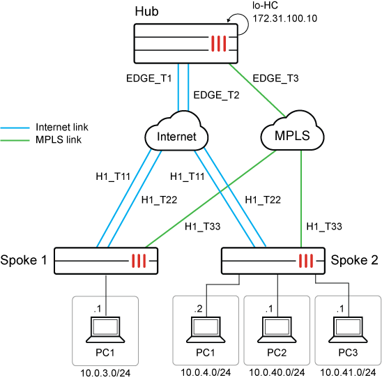

The configuration example illustrates the edge discovery and path management processes for a typical hub and spoke topology. This example focuses on SD-WAN configuration for steering traffic and establishing shortcuts in the direction from Spoke 1 to Spoke 2.
Currently, ADVPN 2.0 only supports IPv4.
Network Topology
In this example, BGP per overlay was used for dynamic routing to distribute the LAN routes behind each spoke to the other spoke. However, this was a design choice. You can also use BGP on loopback for this example.
Spokes 1 and 2 have the following VPN overlays between themselves and the hub:
VPN Overlays
IP address on Spoke 1
IP address on Spoke 2
H1_T11
172.31.80.1/32
172.31.80.2/32
H1_T22
172.31.81.1/32
172.31.81.2/32
H1_T33
172.31.82.1/32
172.31.82.2/32

Throughout this example, transport group 1 is used for VPN overlays over Internet links while transport group 2 is used for the VPN overlay over an MPLS link.
In this example, user traffic is initiated behind Spoke 1 and destined to Spoke 2. Because of this, Spoke 1 is considered the local spoke, and Spoke 2 is considered the remote spoke.
Network Topology
VPN Overlays

In this scenario, PC1 connected to Spoke 1 initiates an ICMP ping destined for PC1 connected to Spoke 2. Therefore, this user traffic matches SD-WAN rule 1 and triggers shortcut path selection and establishment.
On Spoke 1, in the IKE debug (diagnose debug application ike -1), debug messages indicate that multiple direct shortcut-query packets are being sent to Spoke 2:
ike :VWL_ADVPN_MSG_T_TRIGGER
ike V=root:0 looking up shortcut by addr 172.31.80.2, resp-name:H1_T11, name H1_T22, peer-addr 172.31.3.101:0
ike V=root:0:H1_T22: send shortcut-query
ike V=root:0 looking up shortcut by addr 172.31.81.2, resp-name:H1_T22, name H1_T22, peer-addr 172.31.3.105:0
ike V=root:0 looking up shortcut by addr 172.31.82.2, resp-name:H1_T33, name H1_T33, peer-addr 172.31.4.101:0
ike V=root:0:H1_T33: send shortcut-query
From the diagnostic command on Spoke 1, observe that multiple shortcuts are triggered in bold based on the ADVPN 2.0 path management calculation where in-SLA overlays within the same transport group were selected.

From the diagnostic command on Spoke 2, observe the shortcuts in bold:
Branch2_FGT# diagnose sys sdwan  health-check
 Health Check(HUB):
 Seq(3 H1_T33): state(alive), packet-loss(0.000%) latency(0.120), jitter(0.007), mos(4.404), bandwidth-up(999999), bandwidth-dw(999997), bandwidth-bi(1999996) sla_map=0x1
 Seq(3 H1_T33_0): state(alive), packet-loss(0.000%) latency(0.128), jitter(0.003), mos(4.404), bandwidth-up(1000000), bandwidth-dw(1000000), bandwidth-bi(2000000) sla_map=0x1
 Seq(1 H1_T11): state(alive), packet-loss(0.000%) latency(0.180), jitter(0.008), mos(4.404), bandwidth-up(999999), bandwidth-dw(999997), bandwidth-bi(1999996) sla_map=0x1
 Seq(1 H1_T11_0): state(alive), packet-loss(0.000%) latency(0.259), jitter(0.023), mos(4.404), bandwidth-up(1000000), bandwidth-dw(1000000), bandwidth-bi(2000000) sla_map=0x1
 Seq(1 H1_T11_1): state(alive), packet-loss(0.000%) latency(0.257), jitter(0.014), mos(4.404), bandwidth-up(1000000), bandwidth-dw(1000000), bandwidth-bi(2000000) sla_map=0x1
 Seq(2 H1_T22): state(alive), packet-loss(0.000%) latency(250.169), jitter(0.009), mos(3.993), bandwidth-up(999994), bandwidth-dw(999997), bandwidth-bi(1999991) sla_map=0x0
 Seq(2 H1_T22_1): state(alive), packet-loss(0.000%) latency(0.245), jitter(0.013), mos(4.404), bandwidth-up(1000000), bandwidth-dw(1000000), bandwidth-bi(2000000) sla_map=0x1
 Seq(2 H1_T22_0): state(alive), packet-loss(0.000%) latency(0.223), jitter(0.005), mos(4.404), bandwidth-up(1000000), bandwidth-dw(1000000), bandwidth-bi(2000000) sla_map=0x1
At this point, PC1 connected to Spoke 1 initiated multiple ICMP pings destined for PC1 connected to Spoke 2. The packet capture diagnostic command on Spoke 1 demonstrates that these ICMP pings have been load balanced over all shortcuts:
