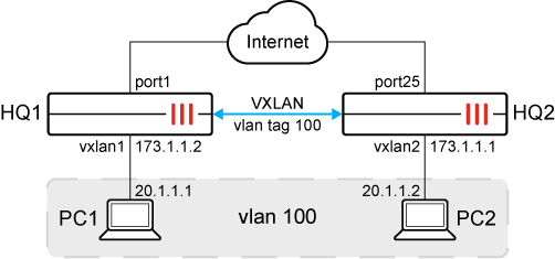

VLANs can be assigned to VXLAN interfaces. In a data center network where VXLAN is used to create an L2 overlay network and for multitenant environments, a customer VLAN tag can be assigned to VXLAN interface. This allows the VLAN tag from VLAN traffic to be encapsulated within the VXLAN packet.
To configure VLAN inside VXLAN on HQ1:

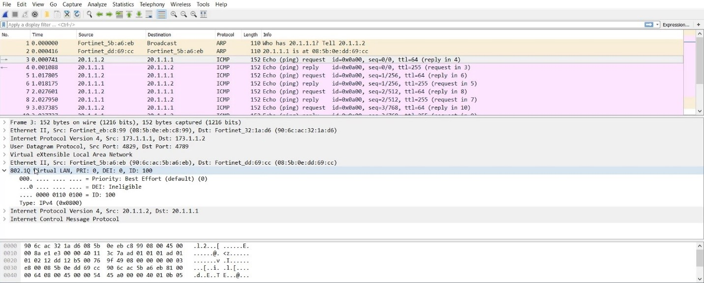

To verify the configuration:
Ping PC1 from PC2.
The following is captured on HQ2:
This captures the VXLAN traffic between 172.1.1.1 and 172.1.1.2 with the VLAN 100 tag inside.
Ping PC1 from PC2.
