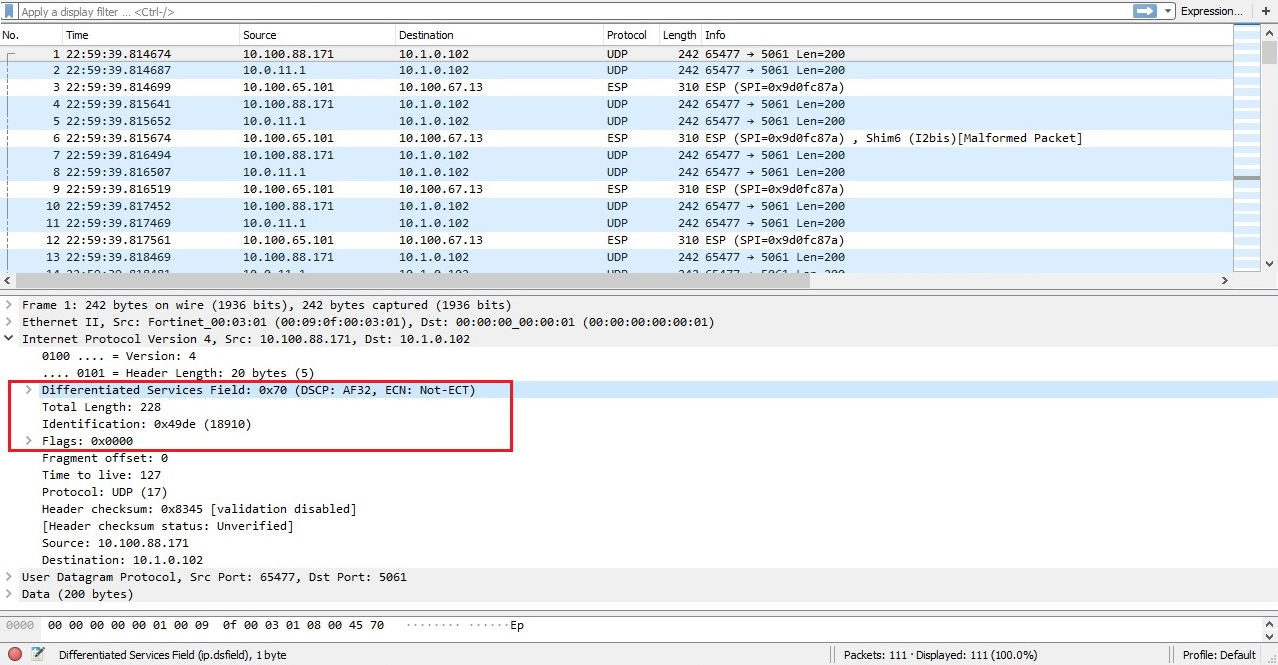

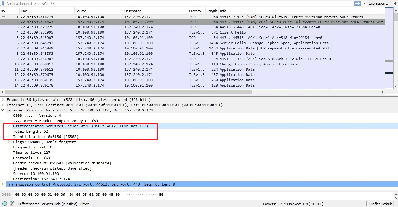

Wireshark is used to verify that VoIP traffic is tagged with the expected DSCP tag, 0x70 or 0x30.
VoIP traffic marked with DSCP tag 0x70:
# diagnose sniffer packet any '(ip and ip[1] & 0xfc == 0x70)' 6 0 l
Web traffic marked with DSCP tag 0x30:
# diagnose sniffer packet any '(ip and ip[1] & 0xfc == 0x30)' 6 0 l

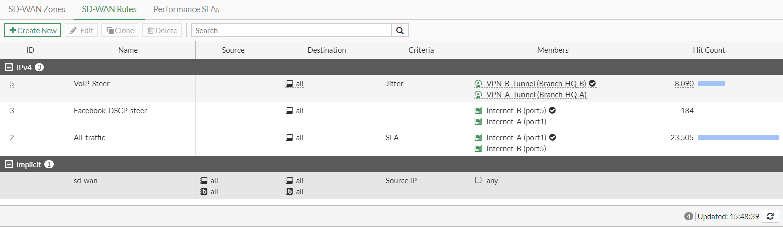

Verifying traffic steering on the SD-WAN rules
Go to Network > SD-WAN and select the SD-WAN Rules tab to check the Hit Count on the SD-WAN interfaces.

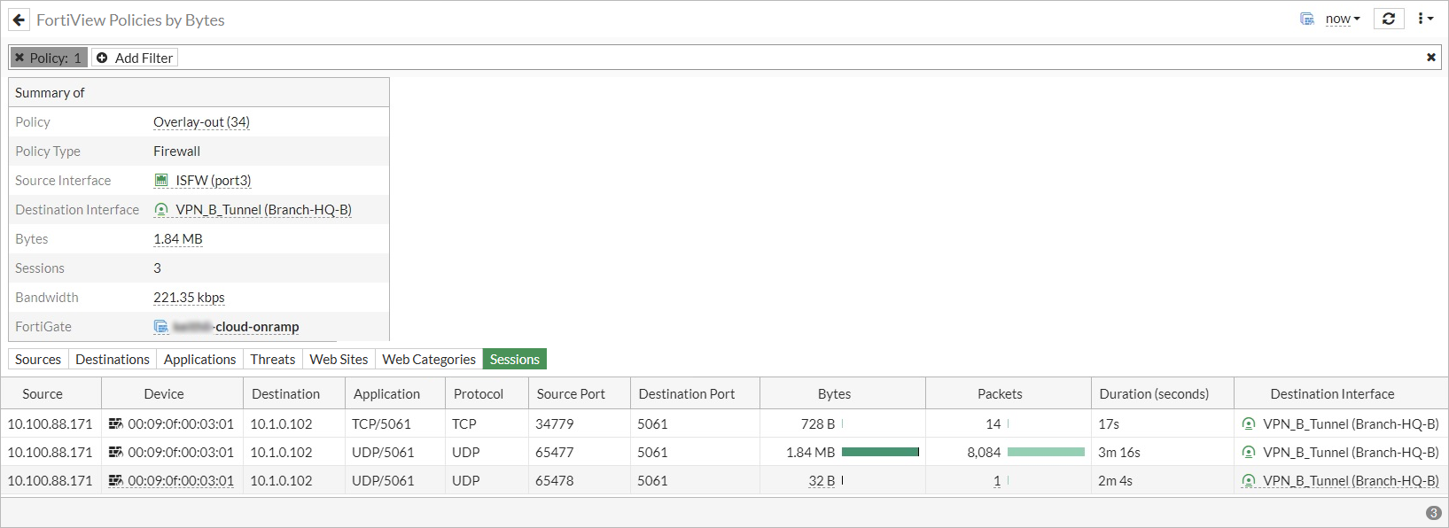

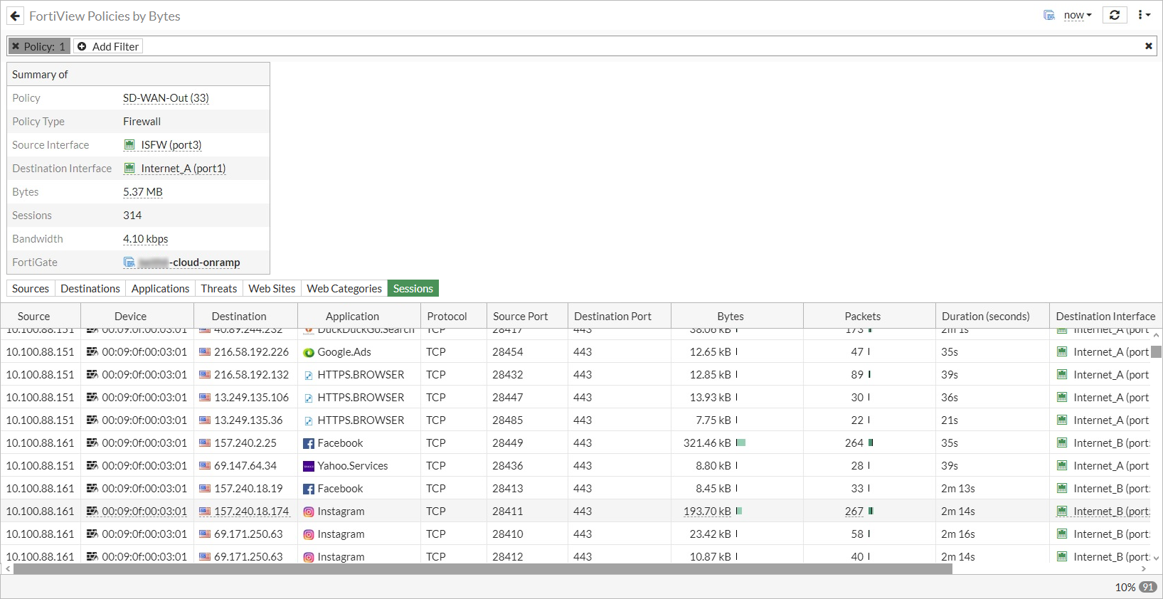

Verifying that steered traffic is leaving from the expected interface
To confirm that web traffic (port 443) flows through the correct underlay interface members, and VoIP traffic flows through the correct overlay interface members, go to Dashboard > FortiView Policies and double click on the policy name.
Web traffic is expected to leave on Interface_A (port1) or Interface_B (port5):
VoIP traffic is expected to leave on the preferred VPN_B_Tunnel (Branch-HQ-B) interface:
