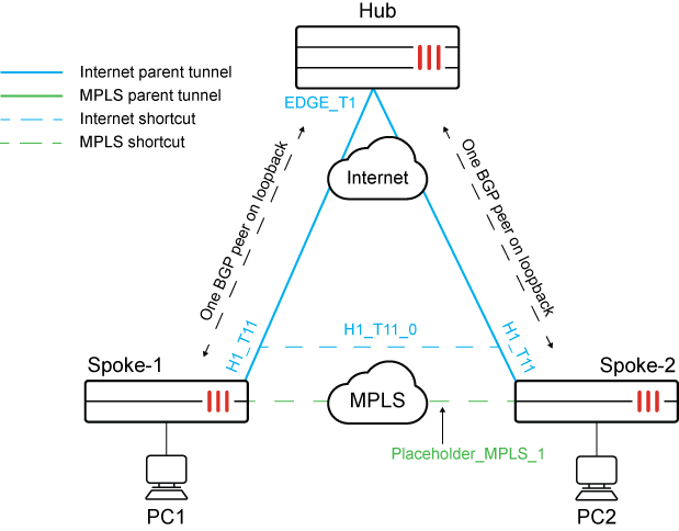

In a typical hub and spoke SD-WAN configuration, the hub uses the same underlay transports as the spokes. However, in unique circumstances, spokes may use different transports than the hub. For example, spokes may have direct MPLS connections that are not connected to the hub. Hubs are not necessarily connected to all the same underlay transports as spokes. In these instances, ADVPN 2.0 can use overlay placeholders to trigger shortcuts between spokes over transports to which hubs are not connected. As long as the path is in-SLA and is the best quality, ADVPN 2.0 uses the overlay placeholders to establish a shortcut tunnel.
In this SD-WAN example, the Hub, Spoke-1, and Spoke-2 all have broadband WAN connections. However, Spoke-1 and Spoke-2 have an additional MPLS connection between them. With ADVPN 2.0 enabled, Spoke-1 and Spoke-2 have regular parent tunnels (H1_T11) to the Hub. Spoke-1 and Spoke-2 also have placeholder parent tunnels configured (Placeholder_MPLS_1), where auto-discovery-dialup-placeholder is enabled and remote-gateway isn't statically specified. As a placeholder tunnel, no connection is established between the spoke and the hub. Instead, the tunnel interface is utilized in the SD-WAN configurations as if it were a regular overlay because shortcuts can be established between spokes in a placeholder overlay.
Traffic is sent from PC-1 to PC-2, and the first bit of traffic goes through the Hub and triggers SHORTCUT_QUERY/SHORTCUT_REPLY exchange with the Hub. When Spoke-1 receives SHORTCUT_REPLY message, which includes SD-WAN information about Spoke-2, Spoke-1 calculates and creates the shortcut between regular parent tunnels and triggers a shortcut between the placeholder parent tunnels too.
Health-checks, which are automatically running on the regular shortcut and the placeholder shortcut, help decide which interface to use for forwarding the remaining traffic.

  2. Send traffic from PC-1 to PC-2:
    When Spoke-1 receives SHORTCUT_REPLY message, which includes SD-WAN information about Spoke-2, Spoke-1 calculates and creates the shortcut between regular parent tunnels, and it triggers a shortcut between the placeholder tunnels too.
    1. Check the health of Spoke-1:
      The health-check is automatically running on the regular shortcut (H1_T11_0) and on the placeholder shortcut (Placeholder_MPLS_1_0).

Example SD-WAN overlay placeholders using ADVPN 2.0
Settings on the spoke relevant to the example:
    edit <placeholder_phase1_interface_name>
        set type dynamic
        set net-device enable
        set auto-discovery-dialup-placeholder enable
To enable overlay placeholder tunnels on Spoke-1 and Spoke-2:
  1. Configure key components on Spoke-1:
    1. Configure a parent tunnel and a placeholder tunnel:
      Tunnel H1_T11 is the parent tunnel, and tunnel Placeholder_MPLS_1 is the placeholder tunnel:
          edit "H1_T11"

    2. Configure SD-WAN:
      Enable ADVPN 2.0 and health-checks for the overlay. Configure the SD-WAN members and their transport groups.
      config system sdwan
          set status enable
          config zone
              edit "overlay"
                  set advpn-select enable
                  set advpn-health-check "HUB"
          config members
              edit 4
                  set interface "H1_T11"
                  set zone "overlay"
                  set source 172.31.0.65
                  set priority 10
                  set transport-group 1
              edit 13
                  set interface "Placeholder_MPLS_1"
                  set zone "overlay"
                  set priority 10
                  set transport-group 2

To check the health status and traffic:
  1. Check the health status on Spoke-1 and Spoke-2, and check the SD-WAN status of Spoke-1:
      The placeholder tunnel (Placeholder_MPLS_1) is dead.

  4. When the regular shortcut tunnel (H1_T11_0) is out of SLA, traffic switches to the placeholder shortcut tunnel (Placeholder_MPLS_1).
    1. Diagnose the SD-WAN service:
      The placeholder shortcut tunnel (Placeholder_MPLS_1) is preferred, and the regular shortcut tunnel (H1_T11_0 overlay) is out of SLA.
