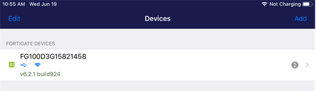

Open FortiExplorer and select your FortiGate from the FortiGate Devices list . A blue USB icon will indicate that you are connected over a USB connection.

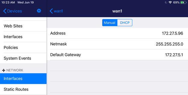

The wan1 interface Address mode is set to DHCP by default. Set it to Manual and enter its Address, Netmask, and Default Gateway, and then Apply your changes.

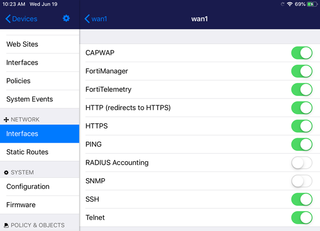

Optionally, configure Administrative Access to allow HTTPS access. This will allow administrators to access the FortiGate GUI using a web browser.

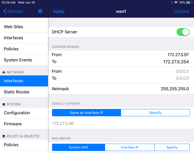

Configure a DHCP Server for the internal network subnet.

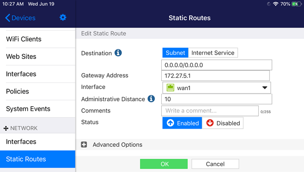

Go to Network > Static Routes and configure the static route to the gateway.

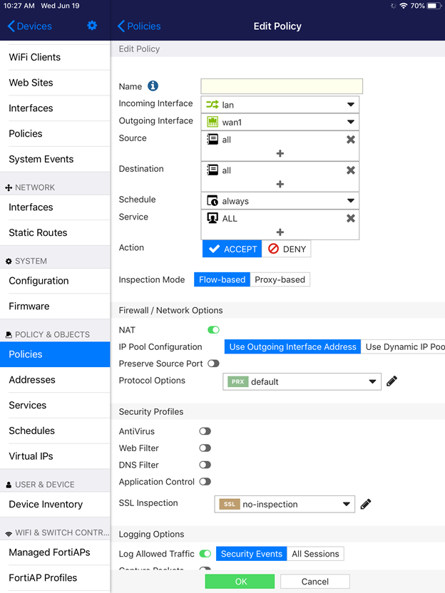

Go to Policy & Objects > Firewall Policy and edit the Internet access policy. Enter a Name for the policy, enable the required Security Profiles, configure Logging Options, then tap OK.
