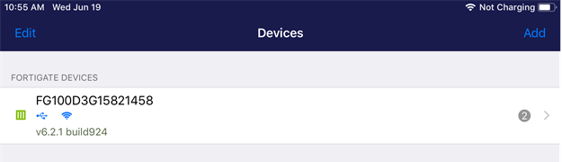

- Open FortiExplorer and select your FortiGate from the FortiGate Devices list . A blue USB icon will indicate that you are connected over a USB connection.

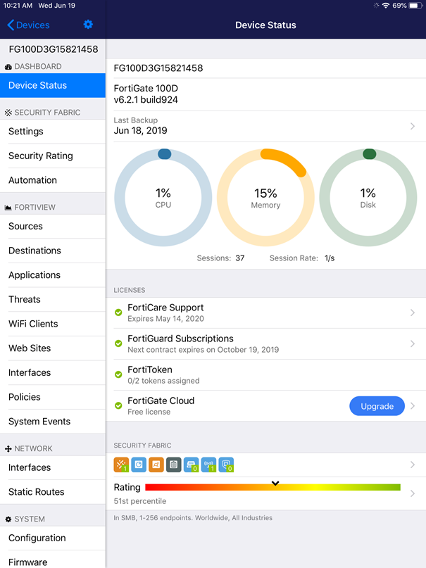

FortiExplorer opens the FortiGate management interface to the Device Status page:

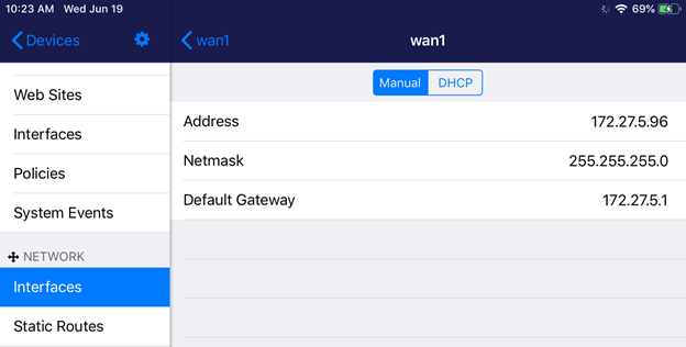

- The wan1 interface Address mode is set to DHCP by default. Set it to Manual and enter its Address, Netmask, and Default Gateway, and then Apply your changes.

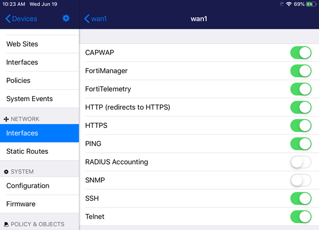

- Optionally, configure Administrative Access to allow HTTPS access. This will allow administrators to access the FortiGate GUI using a web browser.

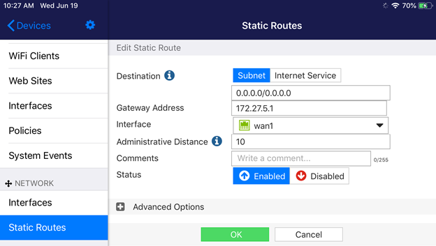

- Go to Network > Static Routes and configure the static route to the gateway.

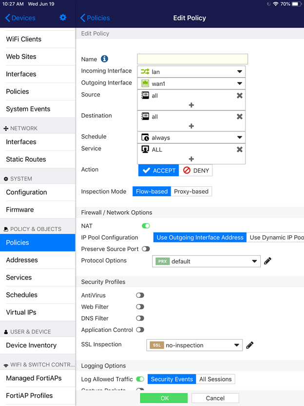

- Go to Policy & Objects > Firewall Policy and edit the Internet access policy. Enter a Name for the policy, enable the required Security Profiles, configure Logging Options, then tap OK.
