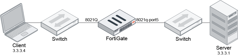

In this example, the FortiGate has two VLAN interfaces. The first interface is a QinQ (802.1ad) interface over the physical interface port3. The second interface is a basic 802.1Q VLAN interface over physical interface port5. These two interfaces are grouped in a virtual wire pair so that bi-directional traffic is allowed. This example demonstrates ICMP from the client (3.3.3.4) sent to the server (3.3.3.1).
