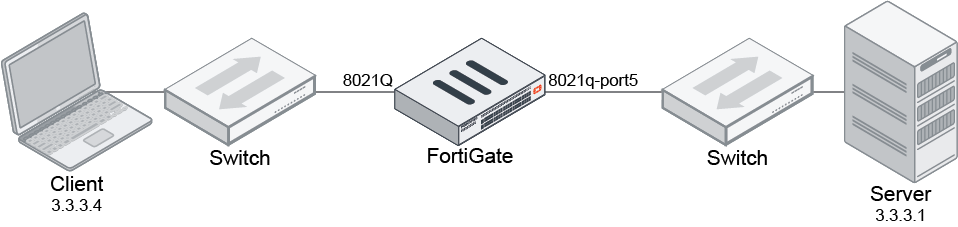

In this example, the FortiGate has two VLAN interfaces. The first interface is a QinQ (802.1ad) interface over the physical interface port3. The second interface is a basic 802.1Q VLAN interface over physical interface port5. These two interfaces are grouped in a virtual wire pair so that bi-directional traffic is allowed. This example demonstrates ICMP from the client (3.3.3.4) sent to the server (3.3.3.1).

To verify that bi-directional traffic passes through the FortiGate:
# diagnose sys session filter policy 1 # diagnose sys session list session info: proto=1 proto_state=00 duration=18 expire=42 timeout=0 flags=00000000 socktype=0 sockport=0 av_idx=0 use=3 origin-shaper= reply-shaper= per_ip_shaper= class_id=0 ha_id=0 policy_dir=0 tunnel=/ vlan_cos=0/0 state=may_dirty br npu statistic(bytes/packets/allow_err): org=168/2/1 reply=168/2/1 tuples=2 tx speed(Bps/kbps): 0/0 rx speed(Bps/kbps): 0/0 orgin->sink: org pre->post, reply pre->post dev=56->55/55->56 gwy=0.0.0.0/0.0.0.0 hook=pre dir=org act=noop 3.3.3.4:3072->3.3.3.1:8(0.0.0.0:0) hook=post dir=reply act=noop 3.3.3.1:3072->3.3.3.4:0(0.0.0.0:0) src_mac=08:5b:0e:71:bf:c6 dst_mac=d4:76:a0:5d:b2:de misc=0 policy_id=1 pol_uuid_idx=534 auth_info=0 chk_client_info=0 vd=3 serial=00005f6c tos=ff/ff app_list=0 app=0 url_cat=0 rpdb_link_id=00000000 ngfwid=n/a npu_state=0x4000c00 ofld-O ofld-R npu info: flag=0x81/0x81, offload=8/8, ips_offload=0/0, epid=187/156, ipid=156/187, vlan=0x0005/0x0021 vlifid=156/187, vtag_in=0x0005/0x0021 in_npu=1/1, out_npu=1/1, fwd_en=0/0, qid=0/5 total session 1
