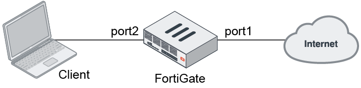

In the following example, a new video filter profile is created to block the Knowledge category.
It is recommended to block the QUIC protocol in application control profiles while applying video filter profiles (see Blocking QUIC manually). By default, FortiOS can only inspect QUIC traffic in HTTP3 in flow mode, and video filtering only operates in proxy mode. By explicitly blocking QUIC in application control, video traffic utilizing the QUIC protocol on UDP/443 will revert to TCP/443 without QUIC, allowing the FortiGate to successfully inspect the traffic. |

- Create the firewall policy:
- Enter the following:
Incoming Interface
port2
Outgoing Interface
port1
Source
All
Destination
All
Service
All
Inspection Mode
Proxy-based
NAT
Enable
Video Filter
Enable and select category_filter
Application Control
Enable and select default
SSL Inspection
deep-inspection
Log Allowed Traffic
All Sessions
- Configure the other settings as needed and click OK.
To configure a video filter based on FortiGuard categories in the CLI:
- Create the video filter profile:
config videofilter profile edit "category_filter" config fortiguard-category edit 5 set action block set category-id 4 set log enable next end next end - Create the firewall policy:
config firewall policy edit 10 set name "client_yt_v4" set srcintf "port2" set dstintf "port1" set srcaddr "all" set dstaddr "all" set action accept set schedule "always" set service "ALL" set utm-status enable set inspection-mode proxy set ssl-ssh-profile "deep-inspection" set application-list "default" set videofilter-profile "category_filter" set logtraffic all set nat enable next end
