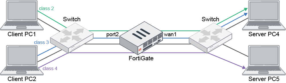

In this example, the port2 interface has a total inbound bandwidth of 100 Mbps. Traffic from certain clients to certain servers are assigned different classes.
IPv6 traffic from any client PCs to server PCs is assigned class 5.

In each of the following cases, the server PCs (PC4 and PC5) are configured as iPerf servers. The client PCs (PC1 and PC2) are configured as iPerf clients. The client sends traffic to the server from the client to server direction, triggering inbound traffic shaping on the port2 interface. The inbound bandwidth on port2 is 100 Mbps.
Case 1: single stream, PC1 to PC4
Traffic is sent from PC1 to PC4. There is no other traffic. Traffic is marked with class ID 2 and allocated the maximum bandwidth 60 Mbps (60%).

Case 2: dual stream, PC1 to PC4, PC2 to PC4
Traffic is sent from both PC1 and PC2 to PC4. PC1 to PC4 traffic is marked with class ID 2 and low priority, and PC2 to PC4 traffic is marked with class ID 3 and high priority. Both class 2 and 3 will be allocated their guaranteed bandwidth first, using up 10% and 20% respectively. The remaining available bandwidth is used by class 3 since it has a higher priority. Class 2 uses around 10 Mbps, and class 3 uses around 90 Mbps.

Case 3: multiple streams
Multiple streams of traffic are sent at the same time:
- PC1 to PC4 traffic is assigned class 2 with low priority, and a guaranteed bandwidth of 10 Mbps.
- PC2 to PC4 traffic is assigned class 3 with high priority, and a guaranteed bandwidth of 20 Mbps.
- PC2 to PC5 traffic is assigned class 4 with high priority, and a guaranteed bandwidth of 30 Mbps.
All classes will be allocated their guaranteed bandwidth first, using up 10 Mbps, 20 Mbps, and 30 Mbps respectively. The remaining available bandwidth (40 Mbps) is shared by class 3 and class 4 based on their guaranteed bandwidth ratio of 20:30.
- Class 3’s share of the remaining 40 Mbps traffic = 40 × 20/(20 + 30) =16 Mpbs
- Class 4’s share of the remaining 40 Mbps traffic = 40 × 30/(20 + 30) =24 Mpbs
Each class is allocated roughly the following bandwidth:
- Class 2: 10 Mbps
- Class 3: 20 Mbps + 16 Mbps = 36 Mbps
- Class 4: 30 Mbps + 24 Mbps = 54 Mbps
