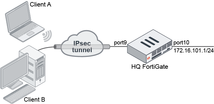

L2TP over IPsec
This is an example of L2TP over IPsec.
This example uses a locally defined user for authentication, a Windows PC or Android tablet as the client, and net‑device is set to enable in the phase1‑interface settings. If net-device is set to disable, only one device can establish an L2TP over IPsec tunnel behind the same NAT device.

To configure L2TP over an IPsec tunnel using the CLI:
- Configure the WAN interface and static route on HQ.
config system interface edit "port9" set alias "WAN" set ip 22.1.1.1 255.255.255.0 next edit "port10" set alias "Internal" set ip 172.16.101.1 255.255.255.0 next end config router static edit 1 set gateway 22.1.1.2 set device "port9" next end - Configure IPsec phase1-interface and phase2-interface on HQ.
config vpn ipsec phase1-interface edit "L2tpoIPsec" set type dynamic set interface "port9" set peertype any set proposal aes256-md5 3des-sha1 aes192-sha1 set dpd on-idle set dhgrp 2 set net-device enable set psksecret sample set dpd-retryinterval 60 next end config vpn ipsec phase2-interface edit "L2tpoIPsec" set phase1name "L2tpoIPsec" set proposal aes256-md5 3des-sha1 aes192-sha1 set pfs disable set encapsulation transport-mode set l2tp enable next end - Configure a user and user group on HQ.
config user local edit "usera" set type password set passwd usera next end config user group edit "L2tpusergroup" set member "usera" next end - Configure L2TP on HQ.
config vpn l2tp set status enable set eip 10.10.10.100 set sip 10.10.10.1 set usrgrp "L2tpusergroup" end - Configure a firewall address that is applied in L2TP settings to assign IP addresses to clients once the L2TP tunnel is established.
config firewall address edit "L2TPclients" set type iprange set start-ip 10.10.10.1 set end-ip 10.10.10.100 next end - Configure a firewall policy.
config firewall policy edit 1 set name "Bridge_IPsec_port9_for_l2tp negotiation" set srcintf "L2tpoIPsec" set dstintf "port9" set srcaddr "all" set dstaddr "all" set action accept set schedule "always" set service "L2TP" next edit 2 set srcintf "L2tpoIPsec" set dstintf "port10" set srcaddr "L2TPclients" set dstaddr "172.16.101.0" set action accept set schedule "always" set service "ALL" set nat enable next end
