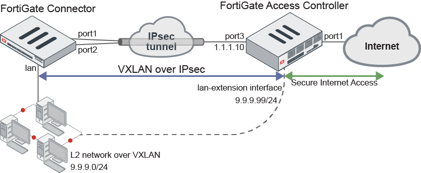

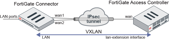

LAN extension mode allows a remote FortiGate to provide remote connectivity to a local FortiGate over a backhaul connection.
The remote FortiGate, called the FortiGate Connector, discovers the local FortiGate, called the FortiGate Controller, and forms one or more IPsec tunnels back to the FortiGate Controller. A VXLAN is established over the IPsec tunnels creating an L2 network between the FortiGate Controller and the network behind the FortiGate Connector.
In this example, the Controller provides secure internet access to the remote network behind the Connector. The Controller has two WAN connections: an inbound backhaul connection and an outbound internet connection. The Connector has two wired WAN/uplink ports that are connected to the internet.
After the Connector discovers the Controller and is authorized by the Controller, the Controller pushes a FortiGate LAN extension profile to the Connector. The Connector uses the profile configurations to form two IPsec tunnels back to the Controller. Additional VXLAN aggregate interfaces are automatically configured to create an L2 network between the Connector LAN port and a virtual LAN extension interface on the Controller. Clients behind the Connector can then connect to the internet through the Controller that is securing the internet connection.

After the FortiGate Connector has been authorized, the Controller pushes the IPsec tunnel configuration to the Connector, forcing it to establish the tunnel and form the VXLAN mechanism.

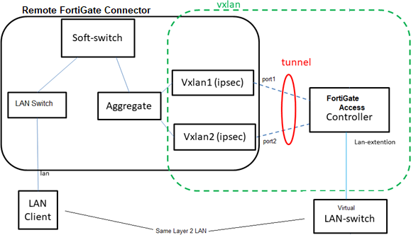

The VXLANs are built on the IPsec tunnels between the Connector and Controller. The VXLAN interfaces are aggregated for load balancing and redundancy. A softswitch combines the aggregate interface with the local LAN ports, allowing the LAN ports to be part of the VXLAN. This combines the local LAN ports with the virtual LAN extension interface on the FortiGate Controller.

VXLAN interfaces are formed over each tunnel:
config system vxlan edit "vx-port1" set interface "ul-port1" set vni 1 set dstport 9999 set remote-ip "10.252.0.1" next edit "vx-port2" set interface "ul-port2" set vni 1 set dstport 9999 set remote-ip "10.252.0.1" next end -
An aggregate interface is configured to load balance between the two VXLAN interfaces, using the source MAC and providing link redundancy:
config system interface edit "le-agg-link" set vdom "lan-ext" set type aggregate set member "vx-port1" "vx-port2" set snmp-index 35 set lacp-mode static set algorithm Source-MAC next end -
The softswitch bridges the aggregate interface and the local LAN to connect the LAN to the VXLAN bridged L2 network that goes to the FortiGate LAN extension interface:
config system switch-interface edit "le-switch" set vdom "lan-ext" set member "le-agg-link" "lan" next end -

The policy allows remote LAN clients to access the internet through the backhaul channel. Clients in the remote LAN behind the Connector receive an IP address over DHCP and access the internet securely through the Controller.
