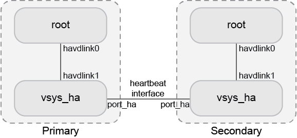

The HA heartbeat allows cluster units to communicate with each other. The heartbeat consists of hello packets that are sent at regular intervals by the heartbeat interface of all cluster units. The hello packets describe the state of the cluster unit (including communication sessions) and are used by other cluster units to keep the cluster synchronized. While the cluster is operating, the HA heartbeat confirms that all cluster units are functioning normally.
HA heartbeat packets are Layer 2 Ethernet frames that use EtherType values of 0x8890 and 0x8891 rather than 0x0800 for normal 802.3 IP packets. The default time interval between HA heartbeats is 200 ms.
As a best practice, it is recommended to isolate the heartbeat devices from the user networks by connecting the heartbeat devices to a dedicated switch that is not connected to any network. The heartbeat packets contain sensitive information about the cluster configuration and may use a considerable amount of network bandwidth. If the cluster consists of two FortiGates, connect the heartbeat device interfaces back-to back using a crossover cable. If there are more than two FortiGates, each heartbeat interface should be connected to a dedicated switch. For example, in a four-member HA cluster with two heartbeat interfaces, there would be two switches (one switch dedicated to each interface).
Upon starting up, a FortiGate configured for HA broadcasts HA heartbeat hello packets from its HA heartbeat interface to find other FortiGates configured to operate in HA mode. If two or more FortiGates operating in HA mode connect with each other, they compare HA configurations (mode, password, and group ID). If the HA configurations match, then the units negotiate to form a cluster.

A heartbeat interface is an Ethernet network interface in a cluster that is used by the FGCP for HA heartbeat communications between cluster units.
By default, two interfaces are configured to be heartbeat interfaces on most FortiGate models. The heartbeat interface configuration can be changed to select an additional or different heartbeat interface. It is possible to select only one heartbeat interface; however, this is not a recommended configuration (see Split brain scenario).
Another important setting in the HA configuration is the heartbeat interface priority. In all cases, the heartbeat interface with the highest priority is used for all HA heartbeat communication. If the interface fails or becomes disconnected, then the selected heartbeat interface with the next highest priority handles all HA heartbeat communication.
If more than one heartbeat interface has the same priority, the heartbeat interface with the highest priority that is also highest in the heartbeat interface list is used for all HA heartbeat communication. If this interface fails or becomes disconnected, then the selected heartbeat interface with the highest priority that is next highest in the list handles all heartbeat communication (see Selecting heartbeat packets and interfaces).
The default heartbeat interface configuration sets the priority of both heartbeat interfaces to 50, and the range is 0 to 512. When selecting a new heartbeat interface, the default priority is 0. The higher the number, the higher the priority.
In most cases, the default heartbeat interface configuration can be maintained as long the heartbeat interfaces are connected. Configuring HA heartbeat interfaces is the same for virtual clustering and for standard HA clustering. Up to eight heartbeat interface can be selected. This limit only applies to FortiGates with more than eight physical interfaces.

Interface IP addresses
An FGCP cluster communicates heartbeat packets using Layer 2 frames over the physical heartbeat interface, but it also communicates other synchronization traffic, logs, and locally generated traffic from subordinate devices over Layer 3 IP packets. Additional virtual interfaces are created in the hidden vsys_ha VDOM, which need to be addressed with IPv4 addresses.
The FGCP uses link-local IPv4 addresses (see RFC 3927) in the 169.254.0.x range for the virtual HA heartbeat interface (port_ha) and for the inter-VDOM link interfaces between the vsys_ha and management VDOM. When members join an HA cluster, each member's heartbeat interface (port_ha) is assigned an IP address from the range of 169.254.0.1 to 169.254.0.63/26. HA inter-VDOM link interfaces (havdlink0 and havdlink1) are assigned IP address from the range of 169.254.0.65 to 169.254.0.66/26.
The IP address that is assigned to a virtual heartbeat interface depends on the serial number priority of the member. Higher serial numbers have a higher priority, and therefore a lower serialno_prio number, for example:
# diagnose sys ha status
FGVM08TM20002002:    Secondary, serialno_prio=0, usr_priority=128, hostname=FGVM08TM20002002
FGVM08TM19003001:      Primary, serialno_prio=1, usr_priority=128, hostname=FGVM08TM19003001
The member with serialno_prio=0 is assigned IP address 169.254.0.1, serialno_prio=1 is assigned 169.254.0.2, and so forth.
To view the HA heartbeat interface IP address of the primary unit:
# get system ha status
vcluster 1: work 169.254.0.2
To view all the assigned IP addresses of a device:
# diagnose ip address list
IP=172.16.151.84->172.16.151.84/255.255.255.0 index=3 devname=port1
IP=192.168.2.204->192.168.2.204/255.255.255.0 index=6 devname=port2
IP=10.10.10.1->10.10.10.1/255.255.255.0 index=9 devname=port3
IP=127.0.0.1->127.0.0.1/255.0.0.0 index=13 devname=root
IP=127.0.0.1->127.0.0.1/255.0.0.0 index=16 devname=vsys_ha
IP=169.254.0.2->169.254.0.2/255.255.255.192 index=17 devname=port_ha
IP=127.0.0.1->127.0.0.1/255.0.0.0 index=18 devname=vsys_fgfm
IP=169.254.0.65->169.254.0.65/255.255.255.192 index=19 devname=havdlink0
IP=169.254.0.66->169.254.0.66/255.255.255.192 index=20 devname=havdlink1
When generating traffic from a subordinate unit, traffic will be routed to the primary unit’s port_ha virtual heartbeat interface. From there, if traffic is destined to another network, the traffic is routed from the vsys_ha VDOM to the management VDOM by the havdlink interfaces.
Use the execute traceroute command on the subordinate unit to display HA heartbeat IP addresses and the HA inter-VDOM link IP addresses.
To trace the route to an IP address on a subordinate unit:
# execute ha manage 1
# execute traceroute 172.20.20.10
traceroute to 172.20.20.10 (172.20.20.10), 32 hops max, 72 byte packets
1 169.254.0.1 0 ms 0 ms 0 ms
2 169.254.0.66 0 ms 0 ms 0 ms
3 172.20.20.10 0 ms 0 ms 0 ms
To run a sniffer trace on the primary unit to view the traffic flow:
# diagnose sniffer packet any 'net 169.254.0.0/24' 4 0 l
