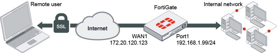

This is a sample configuration of remote users accessing the corporate network and internet through an SSL VPN by tunnel mode using FortiClient.
Sample topology
Sample configuration
WAN interface is the interface connected to ISP. This example shows static mode. You can also use DHCP or PPPoE mode. The SSL VPN connection is established over the WAN interface.

  1. Download FortiClient from www.forticlient.com.
  2. Open the FortiClient Console and go to Remote Access.
  3. Add a new connection:
    • Set VPN Type to SSL VPN.
    • Set Remote Gateway to the IP of the listening FortiGate interface, in this example, 172.20.120.123.
  4. Select Customize Port and set it to 10443.
  5. Save your settings.
  6. Use the credentials you've set up to connect to the SSL VPN tunnel.
  7. After connection, all traffic except the local subnet will go through the tunnel FGT.
  8. Go to VPN > Monitor > SSL-VPN Monitor to verify the list of SSL users.
  9. On the FortiGate, go to Log & Report > Forward Traffic and view the details for the SSL entry.
