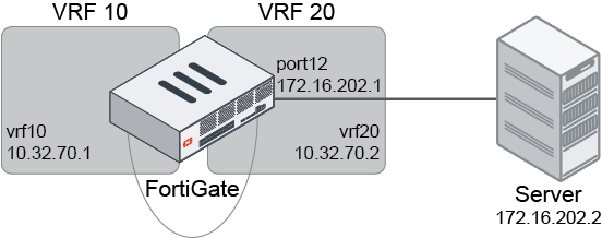

In this example, there is an NPU VDOM link that is configured on the root VDOM. Two VLANs, vrf10 and vrf20, are created on either ends of the NPU VDOM link, each belonging to a different VRF.
When pinging from the vrf10 interface in VRF 10 to the destination server 172.16.202.2, since there is a single static route for VRF 10 with a gateway of vrf20/10.32.70.2, traffic is sent to the next hop and subsequently routed through port12 to the server.
As seen in the sniffer trace, the ICMP replies are received on port12 in VRF 20, then pass through vrf20, and are ultimately forwarded back to vrf10 in VRF 10. The traffic flow demonstrates that local-out traffic sourced from one VRF passing through another VRF can return back to the original VRF.
