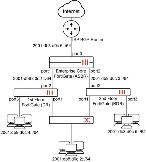

In this example, three FortiGate devices are configured in an OSPF network.
  • 1st Floor FortiGate is the Designated Router (DR). It has the highest priority and the lowest IP address, to ensure that it becomes the DR.
  • 2nd Floor FortiGate is the Backup Designated Router (BDR). It has a high priority to ensure that it becomes the BDR.
  • Enterprise Core FortiGate is the Autonomous System Border Router (ASBR). It routes all traffic to the ISP BGP router for internet access. It redistributes routes from BGP and advertises a default route to its neighbors. It can allow different types of routes, learned outside of OSPF, to be used in OSPF. Different metrics can be assigned to these routes to make them more or less preferred than regular OSPF routes. Route maps could be used to further control what prefixes are advertised or received from the ISP.
Please note that the IPv6 addresses used in this example are for illustrative purposes only and should not be used in your environment.
The 2001:db8::/32 prefix is a special IPv6 prefix designated for use in documentation examples. See RFC 3849 for more information.
FortiGate
Interface
IP address
1st Floor FortiGate (DR) loopback 1.1.1.1
port1 2001:db8:d0c:2::1/64
port2 2001:db8:d0c:1::2/64
port3 2001:db8:d0c:4::1/64
2nd Floor FortiGate (BDR) loopback 2.2.2.2
port1 2001:db8:d0c:2::2/64
port2 2001:db8:d0c:3::2/64
port3 2001:db8:d0c:5::1/64
Enterprise Core FortiGate (ASBR) loopback 13.13.13.13
port1 2001:db8:d0c:1::1/64
port2 2001:db8:d0c:3::1/64
port3 2001:db8:d0c:6::1/64
  • Firewall policies are already configured to allow unfiltered traffic in both directions between all of the connected interfaces.
  • The interfaces are already configured. The cost for all of the interfaces is left at 0.
  • The OSPF network belongs to Area 0, and is not connected to any other OSPF networks. All of the routers are part of the backbone 0.0.0.0 area, so no inter-area communications are needed.
  • Enterprise Core FortiGate redistributes BGP routes into the OSPF AS and peers with the ISP BGP Router over eBGP. For information about configuring BGP, see Basic IPv6 BGP example.
  • The ISP IPv6 address is 2001:db8:d0c:6::2/64.
FortiGate
Interface
IP address

      O E2    64:ff9b::/96 [110/10] via fe80::20c:29ff:fe6b:b2bf, port1, 00:00:55
      C       2001:db8:d0c:1::/64 via ::, port2, 01:28:14
      C       2001:db8:d0c:2::/64 via ::, port1, 01:28:14
      O       2001:db8:d0c:3::/64 [110/2] via fe80::20c:29ff:fe6b:b2bf, port1, 00:00:56
      C       2001:db8:d0c:4::/64 via ::, port3, 01:28:14
      O       2001:db8:d0c:5::/64 [110/2] via fe80::20c:29ff:fe6b:b2bf, port1, 00:33:59
      C       fe80::/64 via ::, port3, 01:28:14
