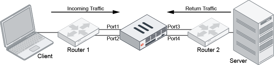

When enabling auxiliary sessions, consider the impact of routing in both traffic directions. In topologies such as SD-WAN hub and spoke or ADVPN deployments, the symmetry of the return traffic is important for maintaining the stability of the session. It is expected that the spoke selects the outbound interface and path, and the other nodes obey and reply symmetrically. It is recommended to disable auxiliary in these scenarios, and others where incoming and return traffic symmetry is expected.
Scenarios
Incoming traffic is from the client to the server. Return traffic is from the server to the client.
Scenario 1 - Return traffic returns on the original outgoing interface
In this scenario, a session is established between port1 and port3. When the return traffic hits port3:
Auxiliary sessions disabled:
The reply to the client egresses on the original incoming interface, port1. If policy routes or SD-WAN rules are configured, the next hop gateway is applied if the output device is the same as the original incoming interface.
Auxiliary sessions enabled:
The reply to the client egresses on the best route in the routing table:
  • If the best route is port1, then it will egress on port1.
  • If the best route is port2, then it will egress on port2.
If policy routes or SD-WAN rules are configured, they must be matched to determine the egress interface. If both are configured, policy routes have higher priority.
Scenario 2 - Return traffic returns on an interfaces other than the original outgoing interfaces
In this scenario, a session is established between port1 and port3. When the return traffic hits port4:
  • The session is dirtied and then gets refreshed, and interfaces on the session are updated.
  • If there is a high traffic volume or flapping between the interfaces, the CPU usage increases.
An auxiliary session is created for the existing session, and traffic returns to the client as normal on the auxiliary session.
Scenario 3 - Incoming traffic enters on an interfaces other than the original incoming interfaces
In this scenario, a session is established between port1 and port3. When the incoming traffic hits port2:
An auxiliary session is created for the existing session, and traffic is forwarded to the server as normal on the auxiliary session.
Scenario 4 - the routing table is changed
In this scenario, a session has been established between port1 and port3, when a new route on port4 is updated as the route to the server.
As long as there is a route to the destination, the session will not be dirtied or refreshed. Even though there is a better route, traffic continues on the original path between port1 and port3.
