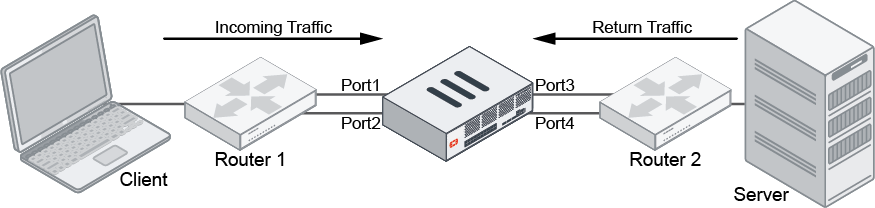

When multiple incoming or outgoing interfaces are used in ECMP or for load balancing, changes to routing, incoming, or return traffic interfaces impacts how an existing sessions handles the traffic. Auxiliary sessions can be used to handle these changes to traffic patterns.

Incoming traffic is from the client to the server. Return traffic is from the server to the client.
Scenario 1 - Return traffic returns on the original outgoing interface
In this scenario, a session is established between port1 and port3. When the return traffic hits port3:
