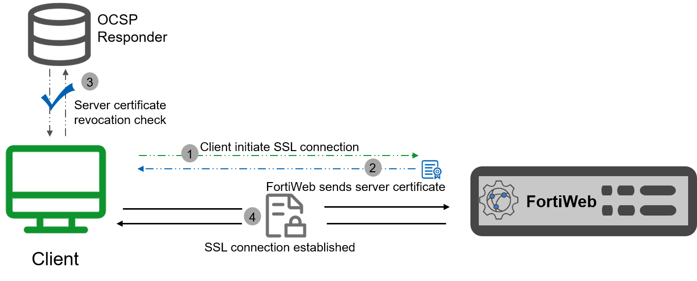

In SSL/TLS connections between the clients (like browsers or apps) and FortiWeb, clients by default check the server certificate presented by FortiWeb, verifying it against a trusted CA store, and contacting the OCSP responder to check whether it is revoked or expired.
While verifying the server certificate’s status through the OCSP responder provides clients with the most up-to-date information, it also introduces an extra network request on the client side. This additional request can increase connection times and lead to noticeable delays in establishing SSL/TLS connections. The diagram below illustrates the SSL connection process between the client and FortiWeb, where the client reaches out to the OCSP responder for the server certificate status.
